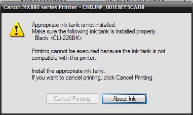

Thanks tigerwan. That leaves me in the throes of indecision about switching to 220/221 carts since you can see through the tank for a visible ink level check though it's not definitely established that they'll fit in place of the 225/226's. I was about to go out and buy some to try. What would you guys do?

Now we know. I replaced the CLI-226Bk with a CLI-221Bk. No go.
Also worth noting: the cartridge is black like the 226. Can't see the ink level.
I'll be watching for the introduction of a chip resetter for the PGI-225 / CLI-226's.
7,177
Did you swap chips?
flatom
Nov 16, 2008
10
27
Aha! You got me, stratman. I did not. It did fit in the slot OK.
But... given that the 220/221 carts are opaque and a resetter for the new carts may be imminent, I think I'll stay with the 225/226's because, under those conditions, I don't perceive any advantage to switching to 220/221's.
