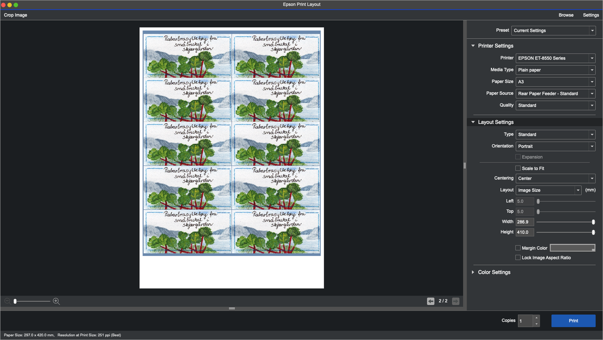

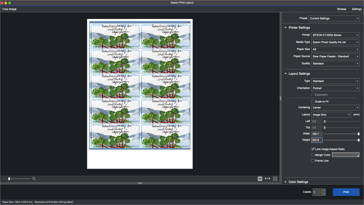

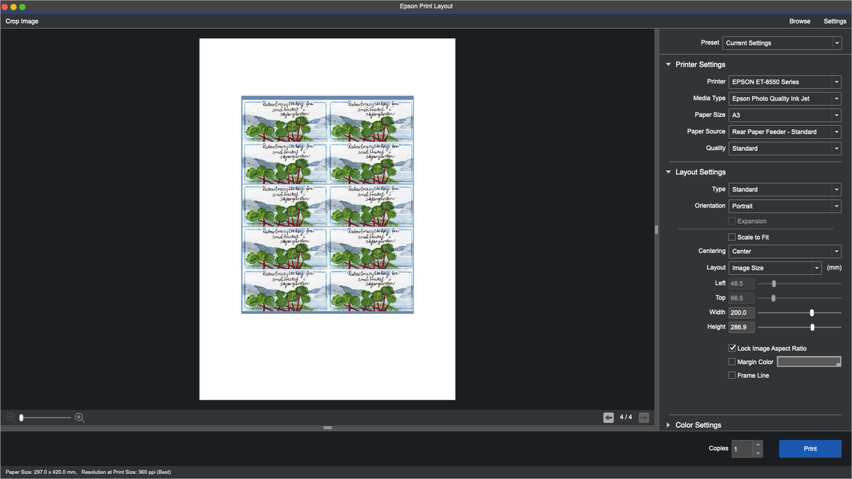

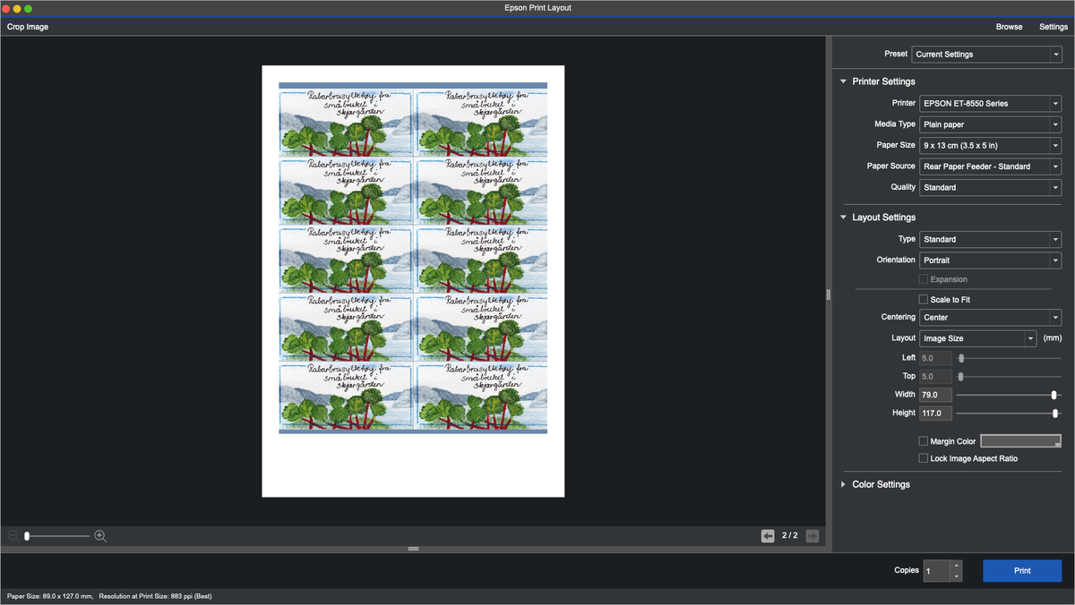

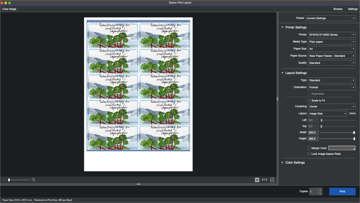

Can anyone please take the time to take a look at this? Though it could be more of a software issue than a printer problem.

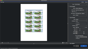

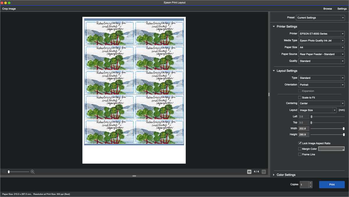

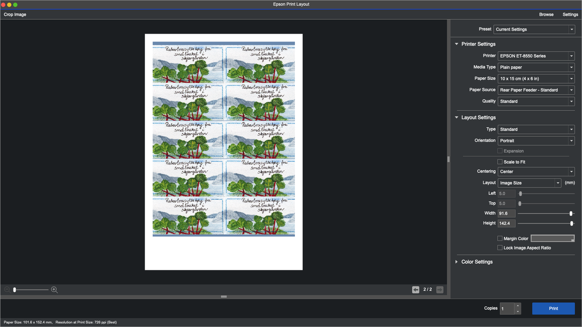

The original image in this case is exactly 20 x 28,7 cm, 360 PPI in size. I've used Epson Print Layout as a PS plugin on Mac (OS 15.1), with the ET 8550 for a long time, more or less, effortlessly. But now it’s impossible to keep the image size consistent when changing paper size in Print Layout 1.5.12. Also in the standalone version. Of course I don't tick “expansion” nor “scale to fit”, 'cause the image (and each sticker) needs to have the same measures as set in PS. In this case, I'm printing stickers on A4 plain paper-stickers.
The preview in Print Layout shows med that the 20 x 28,7 image will be enlarged if printing on A3-paper, but with lower print resolution. Is it just me, or has anyone experienced this using Epson Print Layout?
I wonder if the next step should be to reinstall Print Layout, altogether, hopefully getting rid of all the possible troubling preference files...
(A couple of screenshots, I’m afraid.)

Hi @Doghouse
I don't use EPL too much yet EPL wants to resize to fit the paper (even without you selecting options to expand.
Here is how one can get around it if you really want ot use EPL as opposed to printing right from Photoshop.
1) Make the image in Photoshop the exact size you need, and that size has to fit on the targeted paper size minus the minimum margins of the printer you are using.
2) Then, in the Print panel, click Lock Aspect Ratio
3) Also in the Print panel, type in the size of either width or height of the exact size you set it to in Photoshop (paper size minus margins), and since lock aspect ratio is locked, the other dimension will change to match that aspect ratio.
Those above steps should keep the image the exact size as it was in PS and will not match that in EPL.
As a side note, in the images you have shown, without the Lock Aspect Ratio, some are cropped a bit.
I am pretty sure that's all you need to do to make it work, yet I am not the EPL expert (as I mostly print from PS) and only sharing what has worked for me.
Hope that helps

Thank you so much for even bothering to answer! I'll try your suggestions (Even though I think I've tried them before)....
But still, I don't understand why the workflow suddenly changed in Print Layout after two years. I'll keep you updated. (Whether you like it or not. ....:\)
