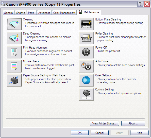

Here are screen shots of driver tab from four dye based Canon printers:
  • iP4900 series:
    And "Auto Power" dialog:
    By default, "Auto Power On" is set to "Enable".

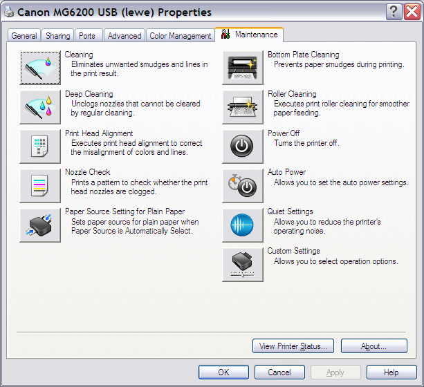

  • MG6200 series:
    "Auto Power On" option is not present(!)

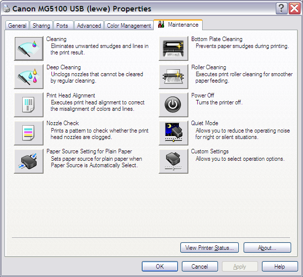

  • MG5100 series:
    No "Auto Power" option at all.

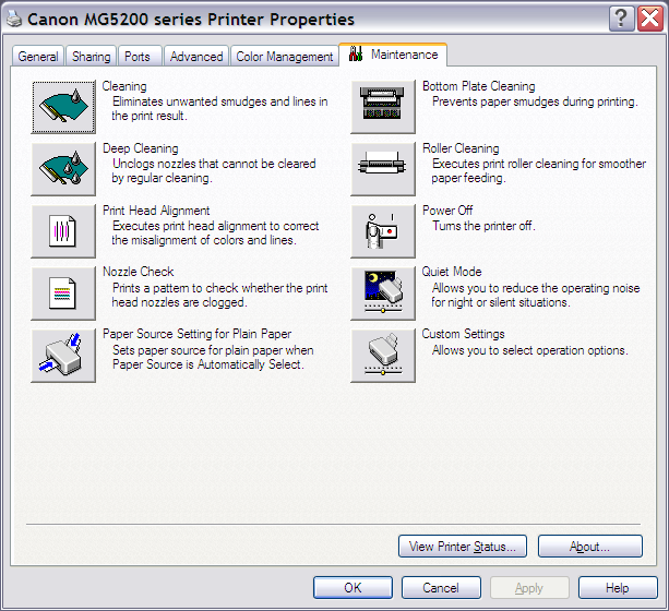

  • MG5200 series:
    Again - no "Auto Power" option at all

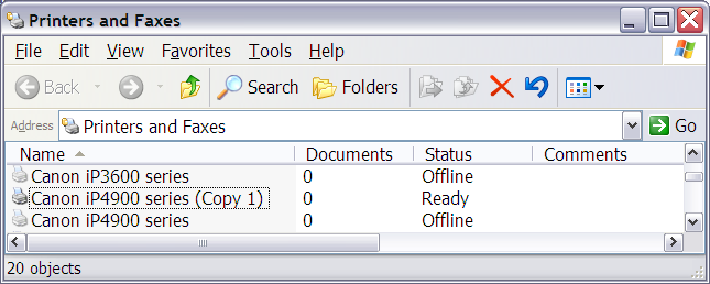

Now, what is the difference between "Auto Power On" settings?
With default setting, "Auto Power On" set to "Enable"
When printer is connected to power outlet in the wall and to computer via USB, then it is instantly reported as a ready in printer folder:
But power led on printer is off(!).
The printer is for sure in power up state - putting anything to printer spooler makes power led on printer blinking and printer running.

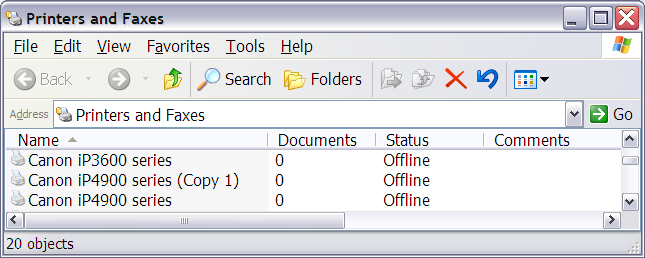

When "Auto Power On" is set to "Disable", the printer is in offline state regardless of connecting it to outlet power and USB.
In such condition, any spooler task is reported as not delivered to the pinter. Printer have to be power up manually by pressing on button.
