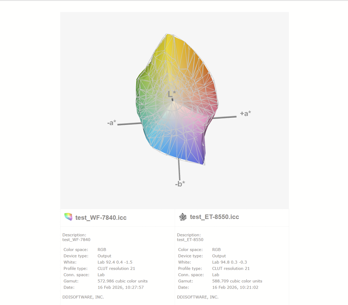

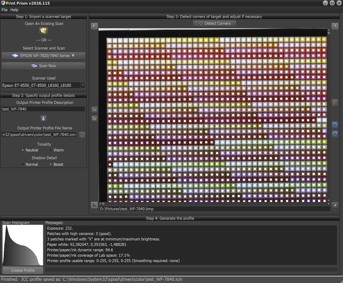

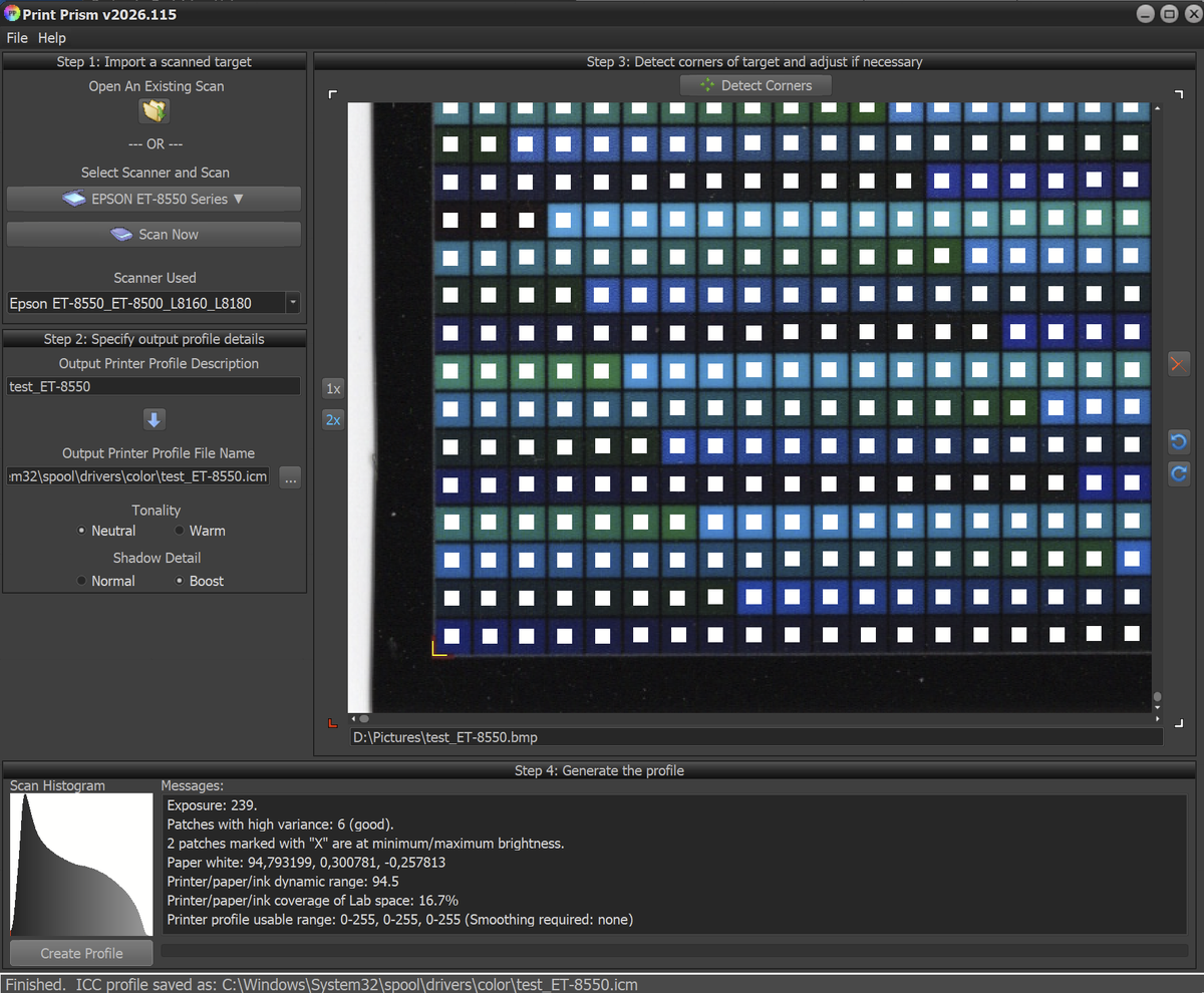

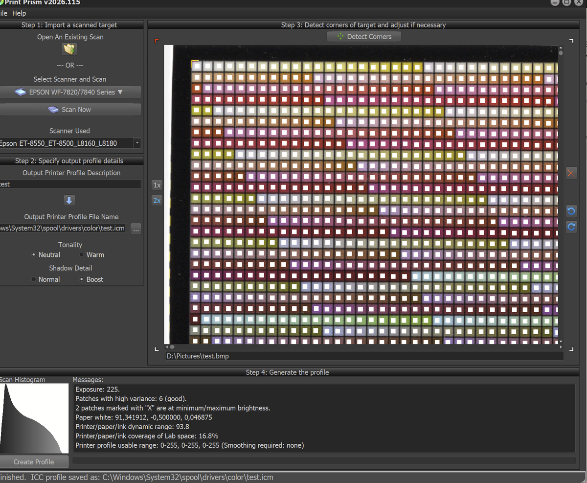

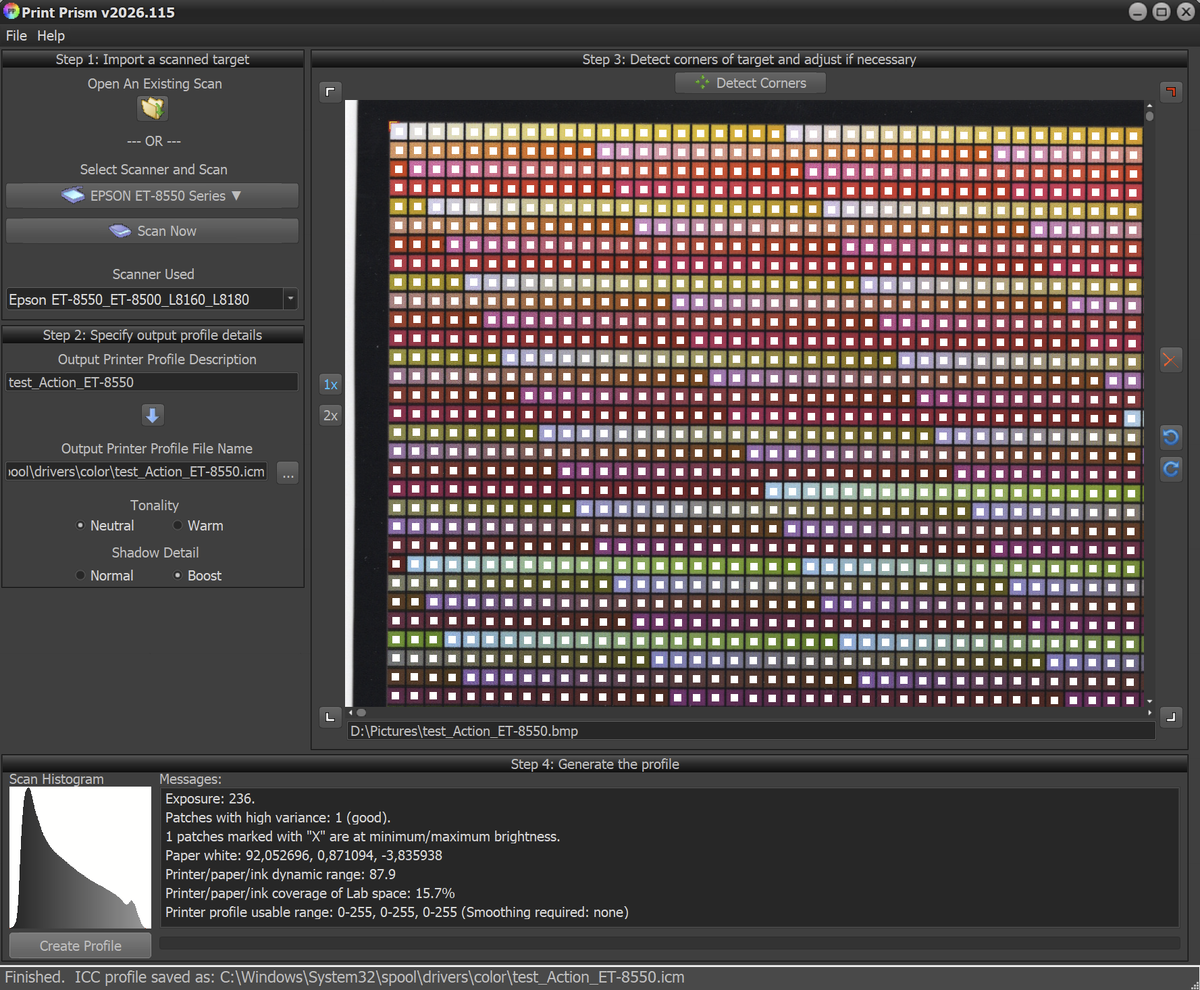

I have to test this, but my first impression that by chance I tried to make a profile with PrintPrism with my unsupported Epson WF-7840 AIO scanner using the built-in ET-8550 scanning engine:
The scan histogram seems to be very healthy and this is the 3D plot in iccview.de with the same target scanned with the officially supported Et-8550 scanner (wired frame):

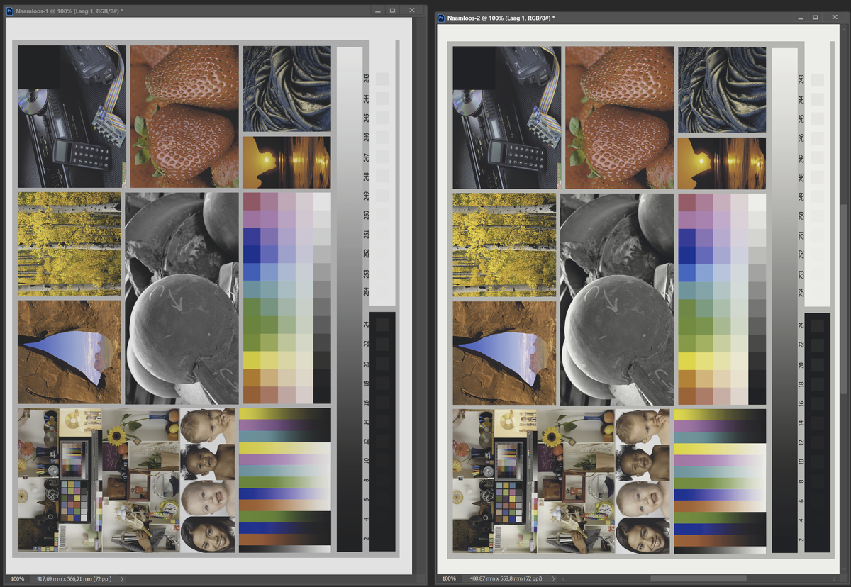

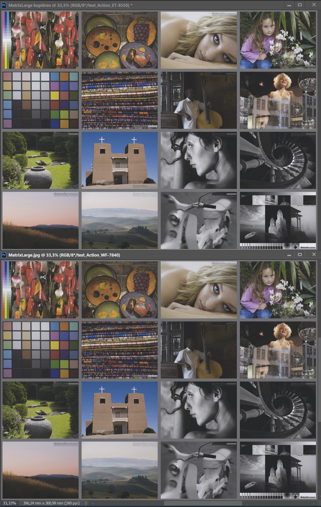

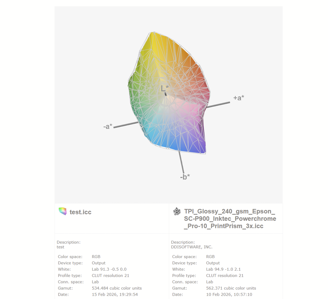

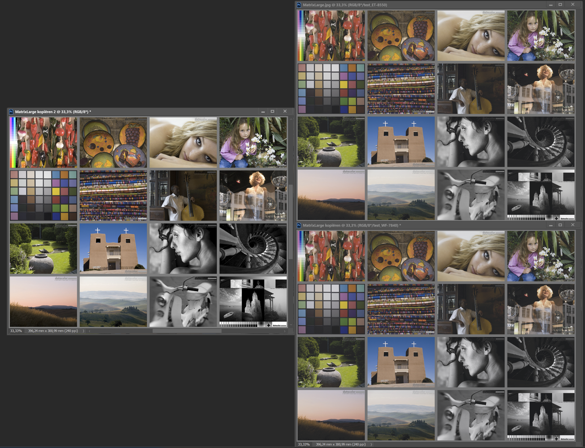

And this the softproofing with both profiles in PS (left with the test profile (WF-7840) and right with the profile made on the officially supported ET-8550):
