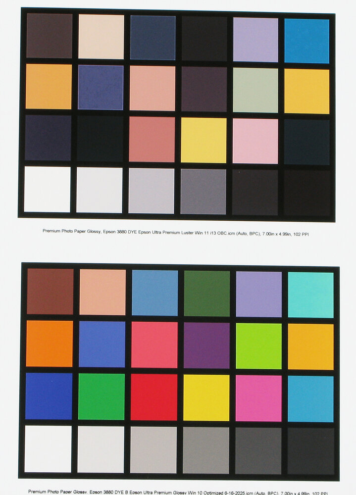

Windows 11 sucks for professional printing so keep your Windows 10 around for any serious color printing. X-rite is still stumped and I've sent them all my data and profiled prints. X-rite put out a new i1Profiler version last week (Still bad.) and MSI put out a new driver for the NvIdia 5090 GPU card that is very different than the current NvIdia one so something is really fouled up someplace. I tried the Nvidia one first as it always worked for Windows 10, but doing the same on Windows 11 and it black-screened on booting up and I had to do a roll back to get it to run. The MSI driver update did not black screen and it was twice as large as the Nvidia driver too - so the OEM driver is prefered.
As to profiing, the Windows 11 colors go dark for me: Greens go dark as do the blues. Something is amiss with their ACM in Windows 11 that claims to use the monitor's screen ID to set their own color scheme (Their ACM.) up. Maybe they are relying on AI to make modifications to all the sundry screens for their ACM to work while avoiding a lot of profiling work? I can get better color using the "Let Windows decide on the print colors" function than going the profile-making route for now in WIndows 11. Better is to profile with 10, and copy that profile into 11 (My current workflow.). Hope x-rite gets the API coding info from MS soon and straightens out the mess.
Below is the ColorChecker color chart x-rite uses at the end of a profile making session in I1Profiler as verification. I made it with the i1 PhotoPro 3 spectrometer with i1Profiler version 3.8.5 (x-rite's newest version installed in both Windows 11 and Windows 10.). I also used the OBC function in i1Profiler and a test sheet to eliminate and OBAs (blues) out of their glossy paper (Seems to have no effect or very little even in WIndows 10.). The Windows 11 profile's end test result is shown on top (e.g. Note the dark blue and green.), and the Windows 10 profile test result is shown under it. Quite a difference!
After wasting 200 sheets (4 boxes) of $1/sheet Epson Ultra Premium Glossy paper, no way will I use profile making out of Windows 11 until something positive is heard from x-rite. I don't know what DataColor has said as I do not use their products for profiling, but maybe their software is different.
