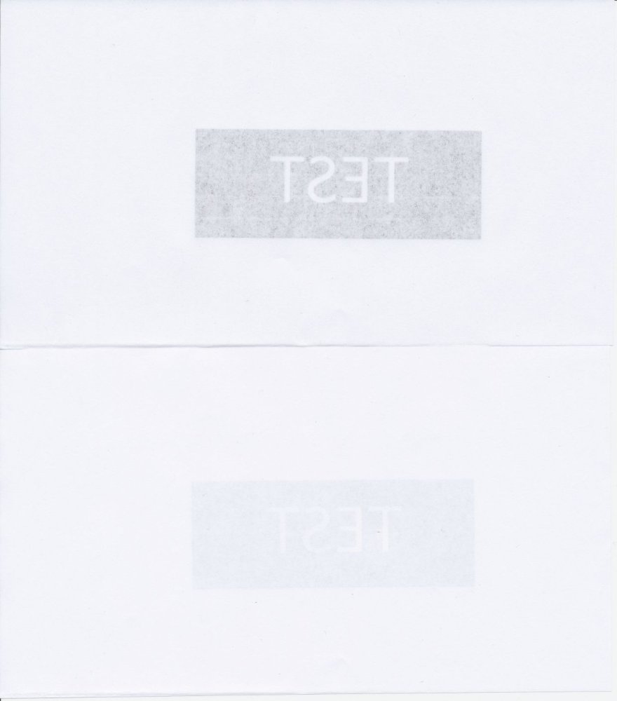

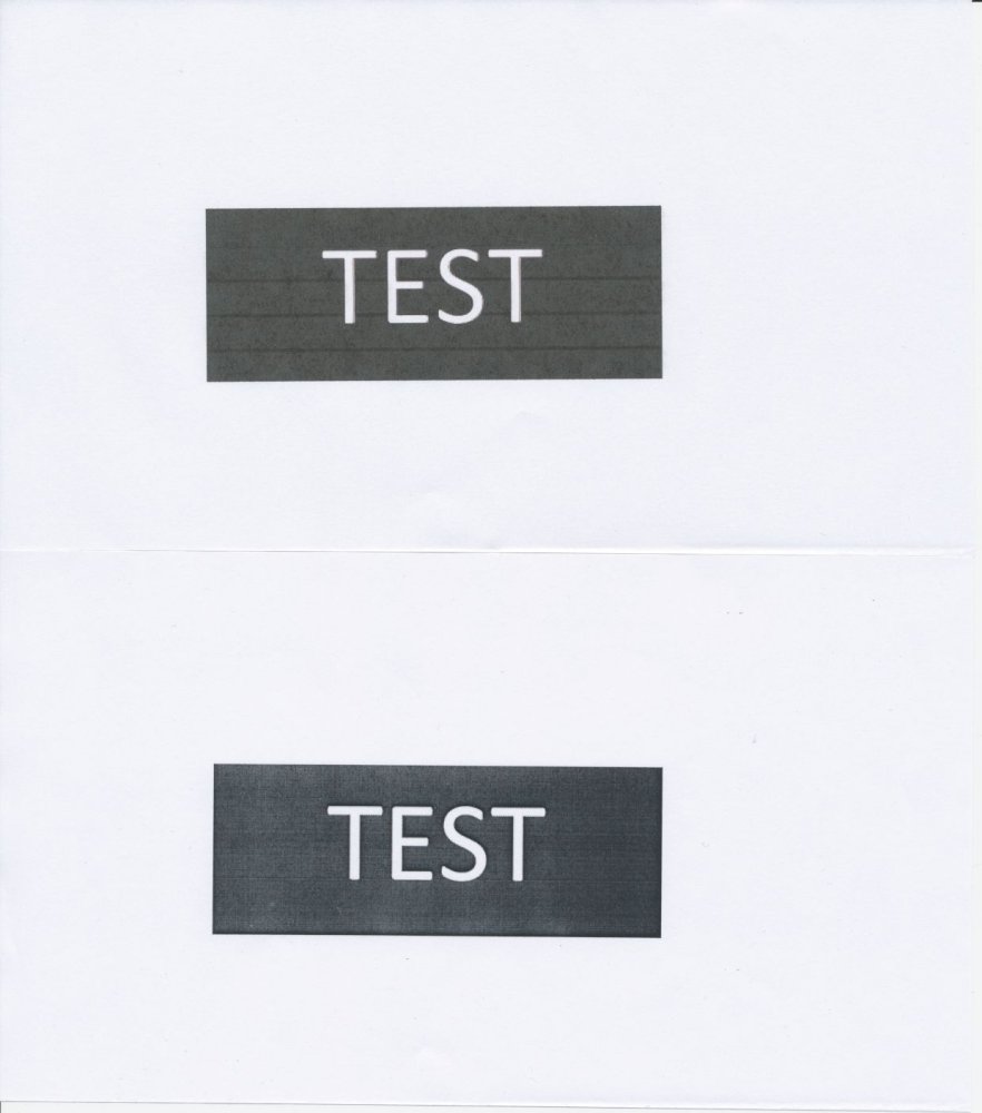

I made a simple test document with The word "TEST" in white on a black background. I printed it on a standard plain 80gsm copier paper using an inkjet printer Canon MP980 and a laser printer HP LaserJet 1018. I scanned the prints from both the front and back side. The inkjet print is at top.
Here is the front page, click to enlarge:
And seen from the back side, click to enlarge:
It is seen the laser is less visible from the backside, but still visible.
