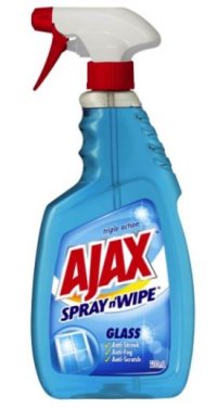

It feels like I have tried almost every dissolver mentioned in forums, FB-groups or Youtube during the past years, but when it was time to unclogg my Epson 4900 I realized I needed something more "powerful" fluid to clean the inklines inside the printhead. Ajax Kitchen....did the job thoroughly.

Where are you located? I don't think this is for sale in the US.

In the US the recommended window cleaner for printhead cleaning is the "Original Windex with Ammonia-D"
Yes, and this is the Ajax version...
