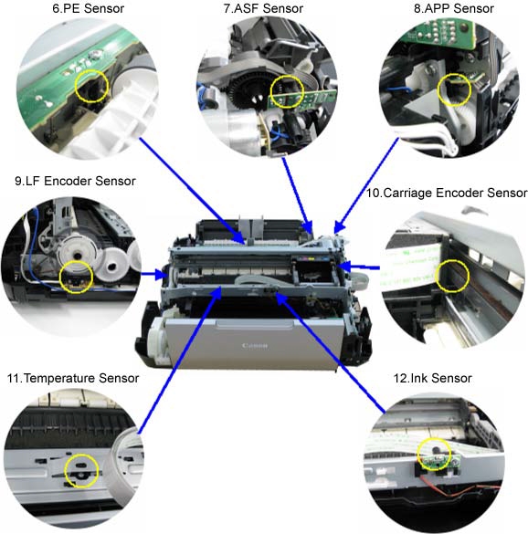

Removed the side covers. Where do I find the 4 mounting screws to remove from them the chassis - and if I'm successful with that, is it worth to try to fix the problem or chuck the thing all together?
5,064
4,914
On the old Canon printers 4 screws were holding the chassis to the bottom part of the enclosure, but on newer printers it might be 6 screws.
According to the service manual, which is found here, error 5700 means ASF cam sensor error, see pages 10/64 and 4/64 to 6/64 inclusive. The error might be caused by a scrap of paper.
The service manual is found on a server, that seems located in Botswana, and that might only be online during business hours. Time zone of Botswana = GMT + 2 hours. The server is often down, so if you get a time out error, try again later.
To get access to the printer chassis you will have to remove the scanner part before removing the rest of printer enclosure, not an easy task. Here a Canon MP830 is disassembled for absorber cleaning, It is not the same printer, but you might get some inspiration.
Some newer Canon printers have the chassis secured to the bottom of the casing by 6 screws instead of 4. Here is an instruction in German for disassembling a Canon iP4600/4700 for absorber change, and here is a Google translation to English. I think the print engine in the MX860 is the iP3600 which is mechanically similar to the iP4600, so this instruction might be useful to locate the well hidden screws.
Here is an image from the service manual showing the location of the ASF cam sensor:
I hope this helps.
