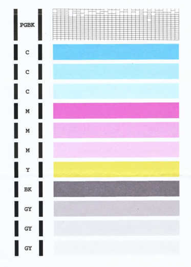

I'm having a stubborn printhead problem and I'm stumped. The nozzle check printout prints the pigment black area incorrectly. Everything else prints fine.
The grid looking bars at the top of the nozzle check printout print with some missing grids near the top of the gridded area. And, it prints like this every single time. I've done some extensive cleaning of the printhead, thinking it was a clog yet it still does this. I'm beginning to wonder if it's truly a clog. Wouldn't a clog print the grid more spiratically, skipping grid squares differently everytime I print a nozzle check sheet, rather than skip the same spots every single time?

We will need to see a nozzle test print. Please post an image of one.

I've enclosed pictures that you requested to see my problem. As you can see in the first picture, when I print the entire nozzle check sheet it all prints fine except the portion of the pigment ink cartridge at the top of the sheet. I then printed that portion larger for you to see it better. This is how this prints every single time. Never a variation. Wouldn't a clog vary in where the skips were in the grid represented on the nozzle check sheet?
The last picture shows some actual type printed on a page which allows you to see the result when something other than a nozzle check is printed. About every 6th line is more faint than the rest. This printer has been doing this for quite some time. I've gotten around the problem by using a higher quality print setting, but at times I would really like to run the machine faster for things that don't need high quality.
I've cleaned the printhead, blown canned air into the pigment ink nozzle on the printhead, done several deep cleanings, and nothing works. Is it possible this is not a clog but maybe a problem with the chip reader that is on the printhead? I've had clogs before and never one I couldn't fix.

Looks like clogged nozzles to me. I was concerned the missing lines would have a periodicity to them, indicating an electrical/electronic problem. A pigment ink clog can be very stubborn. Original Windex and soaking time (Overnight), repeated, are your best options other than renewing the Print Head. Note that EVERY horizontal line the the matrix represents a unique, individual PGBK nozzle.
Do not print anything expect nozzle tests until this is resolved. If repeated soaking/cleaning (try blowing air after soaking toward the nozzles, as well as the inlets) makes no difference ( no additional lines appear in the PGBK matrix), then a new print head may be in order.

Sometimes these little clogs can be a bitch to clear if they have being there for a while and gone unnoticed.
Try using the BK black in your large cartridge instead of the PGBK ink,
just suck out the stuff thats in it now and refill with the BK black.
If you run a couple of test sheets with 1 solid black strips in Word and see if the clog disperses for you..:)

I suspect that the priming station seals are not perfectly sealing and allowing the pigment ink to clog. Sometimes even a windex soak is not adequate put a gentle pressure push after soaking will clear it up. This happens more so on those wide nozzle heads. So soak in windex then take windex and gently force it through the printhead inlet. If you can find a syringe that has a diameter small enough to fit around the inlet , cut it off cleanly so it fits around the rubber seal.and use the rubber seals as a seal, plunge down and the small force exerted on the system will force the particles out. Do check the condition of the seals and wipers to make sure that there is not excessive deposits there causing an air leak and smearing of sediment in the wipe operation.

Print a nozzle check, do a deep clean on the PGBK and repeat the nozzle check.
If you have a clogging issue, at least a few of the missing lines should reappear. If the two prints are exactly the same, you may have burned out heaters on the missing nozzles.
