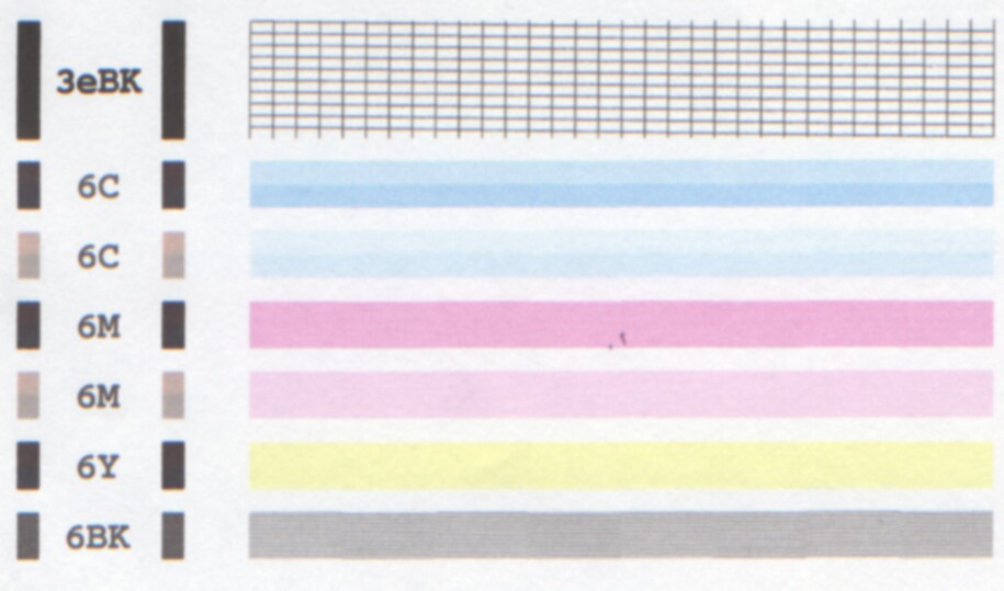

A further possible clue (but may be unrelated): The test print has been progressively deteriorating over the same period. I have run the cleaning utility repeatedly, including deep cleaning, but it has not made any difference. All tanks have ink. Right now the test print looks like:
i.e. three errors: (1) the top '6C' band is divided into two cyan stripes; (2) the 2nd '6C' band is also divided into two cyan stripes, and the corresponding vertical bars are striped grey and magenta; (3) the 2nd '6M' vertical bars are also striped grey and magenta. Printed grey text also appears as grey/magenta striped.

However, you also have an electrical problem in both cyan nozzles. This cannot be fixed and may or may not be contributing to your intermittent power problem. Another of the MP780 printers had the same problem in one of the cyans and then one day it turned itself off and never came back on again. I eventually got rid of that printer but later I wondered if replacing the battery in the printer might have brought it back to life.
So, at a minimum, you need a new print head which you may be able to get from an authorized Canon repair shop for $50 or direct from Canon. They are also available on eBay. Whether this will fix your intermittent problem remains to be seen. It's a gamble.

I installed a new print head a week ago -- looks like the MP760 is back to normal operation, i.e. no error messages, test print is as it should be, etc. So it seems that even an intermittent print head error message was indeed indicating a faulty print head in this case.
