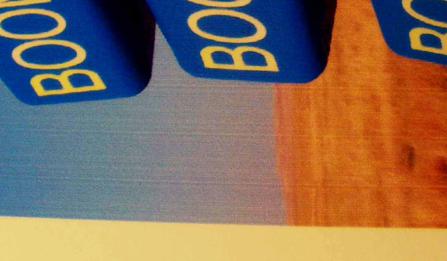

In i9950 can be seen lines on areas of plain color, for example blue sky or asphalt everything else is just fine. Is that normal or problem with ink flow. Nozzle check and head alignment is just fine. That lines I can only see when i look close on picture. That irritates me a lot becouse complex details are fine but sky not.

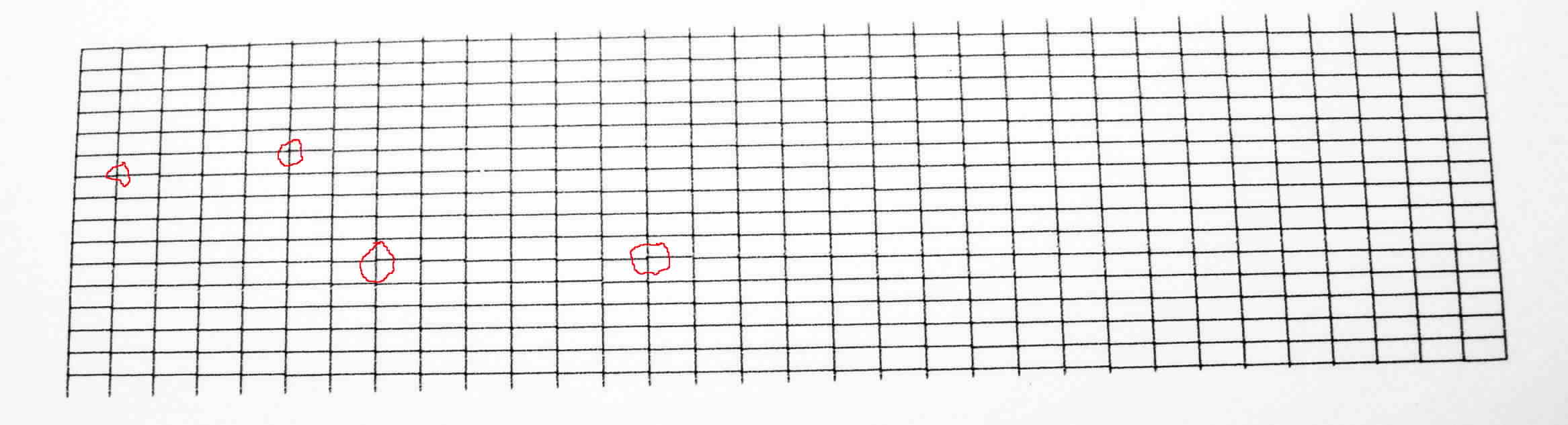

Can you please post a scan of the defect you speak. And a high quality scan of a nozzle check (preferably a service test print instead of a nozzle test print).
Would you consider it "streaking"? Something like this?
http://www.nifty-stuff.com/forum/uploads/2540_dscn8743_1.jpg
You might want to read this entire post. It was my first on this forum. What I beleive I was experiencing was print head nozzle erosion (wear-out).
http://www.printerknowledge.com/threads/canon-i960-banding-issue.2093/

I read your first post and I can say that your case is worst. Mine you can see the sky defect only when you look closely. I know when you look first picture that red ink service print nozzle check have problem. So you think that sky on other picture is because of that?I repeat that defect you can see when printing solid color especially when is light color. For example sea on second picture is OK and top of sky is OK.

I will need to see an enlarged scan of the sky issue. I does not show well on my screen. The photos on my old post are of an area of about 2cm x 3cm.
Are there any misplaced or mispositioned lines in the matrix prints on the nozzle test? Enlarged scans of those matrixes would help, too.
Red ink typically is used only in highest quality printing modes on highest quality papers. And I doubt any is used in the sky.
You may need to replace the printhead to solve this issue.

Sorry...matrix images are still to small. JPEG artifacts are overpowering the detail needed to see misdirected ink. Bigger, more resolution, please. Here's what I see when I attempt to enlarge what you post. Pay particular attention to cyan and magenta matrixes (which make blue).
Here's an example of what I need to see.
http://www.nifty-stuff.com/forum/uploads/2540_black.jpg
Note that the red annotations shows misdirected ink, which causes streaking.
