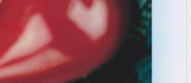

Photos are printed using Canon Easy-PhotoPrint EX on UnitedOffice glossy A4 paper 280g/sqm. At the end of the print, paper touches the printhead.
<---- click to enlarge
This does not happen when printing on HP Everyday PhotoPaper glossy A4 200g/sqm using the same settings.
I tried "prevent paper abrasion" ON - original problem solved, BUT the photo looks realy bad, ink drops in all the wrong places... so it's not a solution.
"prevent paper abrasion" OFF
Any idea on how to solve this?

I suggest you do a new printhead alignment with the paper abrasion setting on, and I recommend doing a manual printhead alignment, using the photo paper.
The printhead has two nozzle sets for printing in each direction, when printing bi-directionally, and these nozzle sets are not parallel but angled slightly; the purpose of the printhead alignment is to get the best alignment of the two parts of the print. As the nozzle sets are not parallel the printhead alignment is dependent on the printhead to paper distance.

Peter, you are a genius! The paper did have a slight curl in that zone and turning it 180 deg in the tray solved the problem. So simple...
Thank you!
