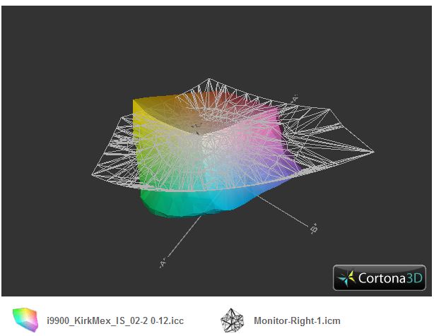

Also remember that inkjet printers can print some colors that your monitor can't display and can't print other colors that your monitor does display. The wire frame in this 3-D model shows the color range (gamut) of my right monitor and the solid shows the color range of my printer (both calibrated). You have asked a very complex question that can't be properly answered with a simple explanation.

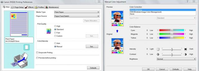

When you go to print go into Preferences color/Intensity Manual Color balance Contrast Brightness.
There are more than enough colour sliders there to alter the output for you to get the right colour balance thats required,
it could take you a half dozen tries to get it right but worth it I reckon.
