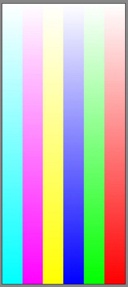

can you please print a pattern like this , download it from here - color bars vertical so that we can see where and when, in which colors the lines show up. I still would like to see the nozzle check if that is possible at all.
Okeydokey,
Please see attached colour bar print and nozzle check print.
These are photos as i do not have a scanner at present
Hope these throw some light on the matter
Regards
B.o.a.b.

I'm concerned there are more than one problem, I see a single dot line across the nozzle check as if one nozzle is constantly firing as long as some others are printing as well. I'm afraid that this is a printhead problem, or something in the circuits driving the nozzles. The yellow field on the right in the nozzle check shows the stepping lines in both directions which as well is pretty unusual. I would try and clean the coding band, that gray plastic stripe going across the print range and through a sensor on the back of the printhead carriage, the sensor reads the positioning codes off the stripe, and the ink fog settles on this plastic band and darkens it. It is quite easy to clean that band, to wipe it off carefully with a piece of kitchen towel paper and windows cleaner. You power on the printer shortly, and pull the power cord as soon as the printhead carriage starts moving. You then can easily move the carriage left and right and out of the way where you want to clean that coding stripe.
There are many of the horizontal lines across the color bar print, regardless of the color printed, I currently don't have a simple solution to fix that.
