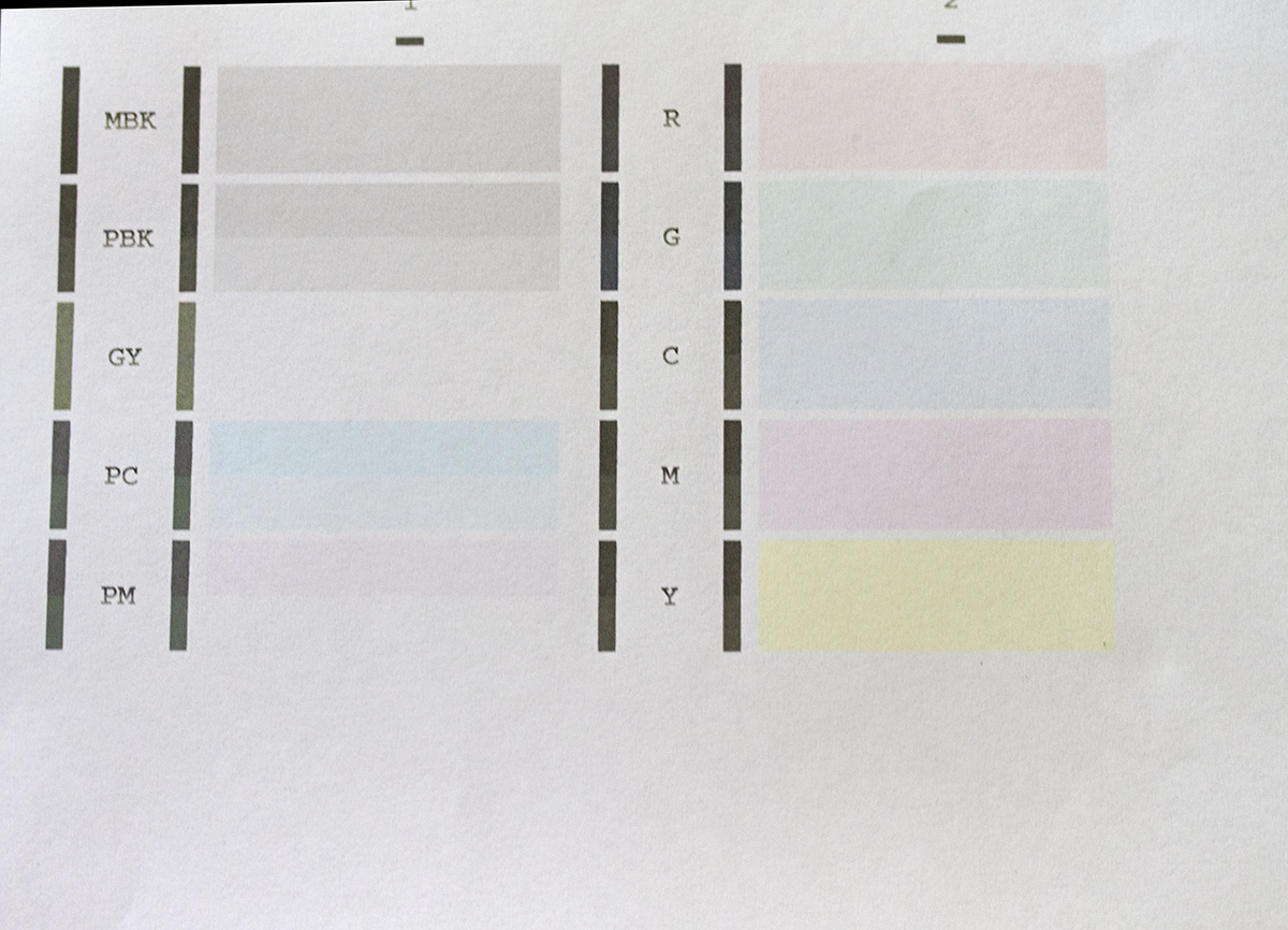

Gday everyone hope you have all been well.
I think my Pro9500 has an electrical problem, at first I thought is was just a clogged printhead but with this nozzle check it looks too uniform to be the printhead a.
Has anyone seen a nozzle check like this?

Gday @rodbam, your nozzle check is looking all too familiar as a head failure, I can’t explain why it does this out of the blue, mine did exactly the same, it did a perfect nozzle check then a perfect Photo and then a nozzle check just like yours.
My current head is in the printer 3 years and I reckon it will last at least another 2 years before it will need replacing, after my last head failure I bought 2 new heads, one to use and one spare, I didn’t want to lose my printer to redundancy, it’s a great 10 year old printer..
P.S. hope you can source another head from somewhere, otherwise it will be a terrible waste..

@rodbam: This type of failure does not seem like an electrical problem in the printhead, it appears to be a nozzle issue. Electrical failure produces a more erratic pattern, if you even get a print.
And "fixing" the printhead, I wouldn't even begin to think that. On Youtube search "manufacturing printhead" and watch the CANON video. I would say the precision needed for (re)assembly is a bit higher than what we could manage at home:(. Presuming you could get it apart without damaging ANY parts.
I would first do a Windex flush on the printhead, and leave the Windex in the printhead overnight, but no tape or anything to keep the Windex from dripping out. Simply flush (NO pressure, REALLY no pressure, just gravity flush) then set on shrinkwrap, nozzles down, and leave overnight. And keep the Windex "off' anything other than the ink channels.
In the morning flush again with Windex (again, no pressure) (don't flush with Water, leave the Windex in the printhead), then put printhead in printer, put in ink cartridges, and print a couple of nozzle checks. If the checks improve, keep printing checks until a nice pattern. If the checks don't improve, I dare say it's the printhead.
As a second procedure in cleaning, I might use a vinyl eraser to clean the contacts, by stroking in the direction of the pins. That tends to remove film from air particle corrosion (possibilities: CO2, H2S, etc.; does copper get a blackish film in your neighborhood?). Then use a soft cloth repeatedly to make sure there are no eraser crumbs left on the contact pins. Pay good attention to this, because any crumbs left will cause more trouble than you already have.
Good luck.
p.s. I am an electrical engineer, retired (now mostly tired). In our neck of the woods we used to have the corrosion problem from trace H2S in the air on relay contacts. Unfortunately we could not fix that problem with erasers. We had to use gold contacts, or at least gold flashed. That's why I buy my mobile's cables and accessories only with gold flashed contacts.

I've seen this a few times on my (second hand) 9500's.
Half of a color lighter is IMO an electrical failure.
Strange you got 3 at the same time (plus the gray).
The original printheads of the 9500 QY6-0065 are more sensible (maybe only because they are now very old) than the QY6-0077 of the 9500 II, but both sooner or later fail.
A new printhead used regularly can last years (but the ask price now is at least €200).
9500 II's have vanished from second hand sites, and Pro10's are seldom offered.
Sadly enough a new Pro10s will be the only solution.

Thanks everyone:) The Hat did you manage to get the printhead working again that gave the same nozzle check as mine? I have done the usual head clean in Windex etc but it stays just the same. It seems there's no new printheads out there except refurbished ones on Ebay & I won't touch them. My pro9500 is getting close to 7 years old so maybe there's no point in putting any more money into. I have only replaced the printhead once & if I could find one it would cost about 30% of the price of a new pro10s. Mind you the price of a new redsetter for the pro10 would be quite a bit a. It seems all my gear is ageing along with me:)
