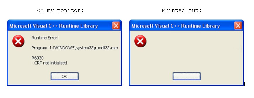

I uninstalled everything under "Canon" in my Control Panel - Add/Remove Programs ... then re-booted ... then went through the entire re-install of the Setup CD, including the print head alignment. The two pages that the head alignment printed look "normal" ... with black and blue squares and rectangles .... but I suspect they don't use the PGBK ink!
Good news is, I now have the "Canon My Printer" icon back in the notifications area of my systray, and now I can view the ink levels in My Printer.
Bad news is ... still nothing coming out from the PGBK cartridge. Here's a pop-up I printed ... next to what it looks like on my monitor:

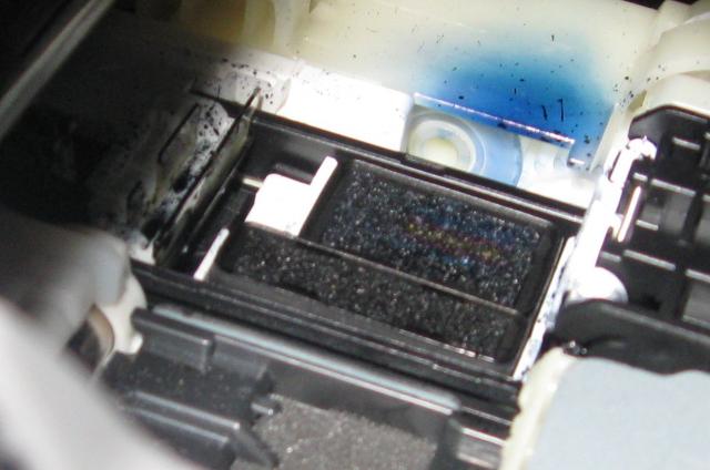

What is the principle behind the purge unit? Is it like a mini-pump that's supposed to suck on the print head when the print head in in it's "rest" position, to keep the print head "primed" with ink?
Yes, I'm aware there are 2 pads ... here's picture of mine:
I will try flooding them again ... and will turn off the printer so the print heads don't eventually end up in the "rest" position, covering the purge pads. I'll let it sit for 10 or 15 minutes, then report back about the water level.
Turns out that turning the printer off causes the print head to return to the "rest" position, covering the purge pads. Is there a way to keep the heads from returning to the purge pads while I'm waiting to see if the water disappears?

You can either leave the cover open, or UNPLUG the printer. If you turn it off, it may still seek the rest position...
The purge system provides a slight negative pressure at the nozzles during cleaning to prime the passageways between the nozzles and the cart.

Open the cover to move the print head to the middle then pull the power cord. No need to turn it off first.

I left the cover open in an earlier "test" ... but it eventually returned to the "rest" position ... like maybe after 5 minutes. I noticed that the "power" button is flashing green, so I'm guessing it's still "thinking" ... and will eventually return as it did previously!
I'll try unplugging the printer!

After 15 minutes, the larger pad looks to no longer be completely flooded (I can once again see the rough surface of the pad) .... but the smaller "skinny" one (for the PGBK print head?) looks pretty much like it did when I first flooded it (rough surface of that pad is not visible).
Is my next step to pull the print head and try soaking it in Windex with Ammonia, or plain water and 10% ammonia? .... or what?

First, remove the carts and head, and blot the heat nozzles gently against clean tissue, see if you get bands imprinted from all colors and pigment black. Report what you get.
Go ahead and soak the head in original windex per cleaning instructions elsewhere in the forum (overnight). Allow to dry, re-install and try again. Nozzle prints only!
Going on the above information it would seem to suggest to me that one of the tubes has come off the bottom of your purge unit.
Now youll have to decide whether you want to pull your printer apart to service
the purge unit and the waste pads or invest in a new printer.
Pulling your printer apart is not as difficult as it sounds and all that is need is a small clear area time and patience. :fl
Armed with a couple of screwdrivers and maybe rubber gloves and you could have the printer apart is next to no time at all,
I would suggest taking some photos of all the places you removed any screws from it will make it easier to remember for reassembly .
Dont make any decisions straight away dwell on it for a while and then decide If it were me
I would certainly undertake the task because the 4500 is a great printer and worth all the effort to try to fix it,
especially after seeing the nozzle check.
You can get as much help as needed on here to answer all of your difficult questions
before during and after you dissemble your printer, so now its up to you to decide.. :woot
