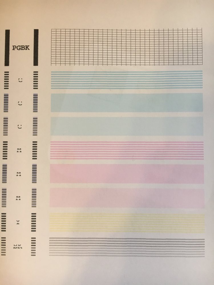

Hello. Im new here. Wondered if anyone could help
I have a Canon IP4500 Printer, I use Genuine Canon CLI-8 cartridges in it.
Very suddenly last night it started missing lines in print. Oddly enough only in the Colours. The cartridges are all relatively new and 3 quarters full. The PGBK cartridge prints fine. (sample enclosed)
I have run all the standard cleaning and printer tests. and i have tried removing the Print head and cleaning that out as well. but unfortunately no change.
Does anyone have any idea as to what would be causing this.
Many thanks

Unfortunately your first post here is not a pleasant one aqnd the news is not good - your print head has irreparably malfunctioned and need a new print head. The news turns even worse since it may be next to impossible to find a new print head for the IP4500. There are print heads sold on EBay, Alibaba, AliExpress and elsewhere that are refurbished or seem to be new, but they are most likely all used despite what looks like new original packaging. Beware print heads sold from China as they may be counterfeit "new" and have a high failure rate.
You could use the 4500 just for black and white text on plain paper setting, but anything with other colors than the Pigment Black cartridge will be affected. You will still need to use all the CLI-8 cartridges, either buying new ones or getting a chip resetter.
At this point, unless you only want to use he 4500 for text as I wrote above then you will need a new printer.

Hi thanks for your response. I thought it might be the print heads as the missing lines were very uniform.

For myself, I wouldn't give up yet. I have been doing a lot of cleaning lately and have had good results, although every one of the symptoms were different. I still wouldn't rush into a new printer. I would do a full flush of the print-head first.
It's a long shot, but I would recommend removing the print-head, and using a syringe with a tube to flush all the channels with Windex (the pure original Windex, no fancy additives). Flush slowly, making sure that all color disappears from the flushed liquid. Use a syringe with a tube that allow a fit that connects to the channels, because you do need to be able to apply a "little" pressure. Do each channel separate. Then let the print head sit in the vinegar overnight. Maybe even do a couple of more flushes during the evening/night. Then flush some more in the morning. Lastly do flush a few times with distilled water. I did not blow the channels dry of water. I didn't want the print-head to try and operate dry. I installed the print-head and the inks, and ran the maintenance cycles. It took only 4 cycles to get a clear pattern. Of course there is no guarantee. As a said above, it's a long shot, but may possibly save buying a new printer. Good Luck!

@richard_tricky, its plain to see that your print head is beyond saving, and as there’s no replacement, it’s time to look for a new printer, I have an aging 4500 myself and bought a Maxify to replace it, but the 4500 still refuses to give in that easy.
