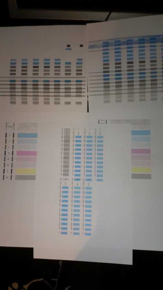

Hello dear forum Members, I'm currently having quite a big problem with my Canon Pixma IP4500 and hope that you might help me diagnose what is causing it or maybe even fix it :)
Printer worked flawlessly up till now, but when I tried to print a high quality Foto on glossy paper today it came up with horizontal blue lines all across it.

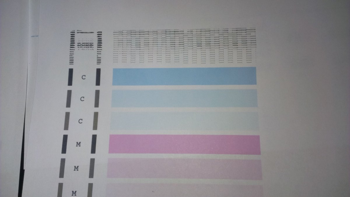

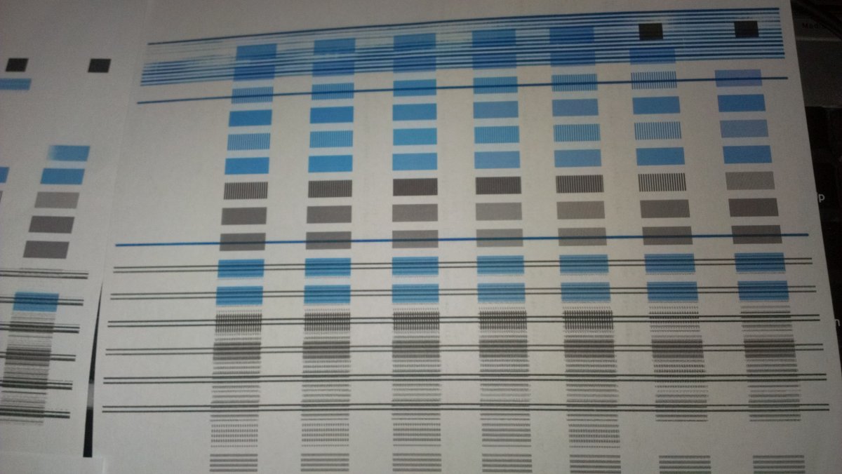

I ran the nozzle check and it showed me a weird printout of the PGBK cartridge. (See attached images) Following that, I ran a deep clean, but that didn't seem to do much. When trying to do a printing head alignment I get black and sometimes cyan horizontal lines across the sheet of paper. I'm unable to do a manual alignment, since the values are smudged beyond legibility.
I replaced both the PGBK and the Cyan cartridges but results are still the same.
Any ideas what is causing this or if it's possible to fix it?
Thanks in advance for any good tips!

I suspect you have an electronic failure in the printer. I would unplug it for 24 hours, and try again afterwards.
You can also try inspecting the timing strip and potentially cleaning it. This is a clear plastic strip with a very fine pattern of lines that runs through the printhead, that acts as an encoder to tell the printhead "where it is" left-to-right. If it's not dirty with ink, then don't clean it.
5,258
5,167
I agree with turbguy. The PGBK nozzle check in image one indicates an electronic print head failure to me, and the horizontal stripes in image two indicates one more electronic failure, in the logic board, to me. So sadly I think the printer is a total loss :(
There is one thing you could try, even if I think the chances of success are very small. Remove the cartridges and the print head and clean the contact pads on the backside of the print head and the contact springs in the print head carriage using a rag moistened with an electronics contact cleaner or isopropyl alcohol.

"A print head is not installed or the installed print head is not compatible with this printer." usually means that the print head is defective. Sadly a defective print head can damage the logic board in the printer, and a damaged logic board can damage a new print head, so replacing a print head is a gamble, for which I don't know the odds for success.
Furthermore the horizontal stripes in your uploaded image 2 indicate a logic board failure to me, so sadly I think the printer is a total loss. :( I would not risk the money for a new print head.
