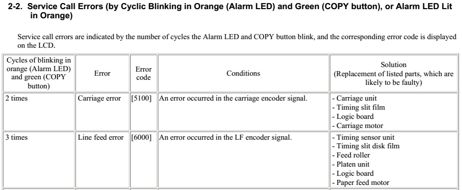

I bought this printer used 2 years ago which replaced a i560 that I had for probably 10 years (it was replaced once IIRC)
The print head died with the dreaded blinking 5 orange LED error message. I had a spare, but that lasted a dozen prints and it starting streaking. I flushed the head out with hot water, that lasted 2 or 3 prints, the streaking returned.
I had a 2nd spare which is working ok so far, but now I'm looking for another spare printhead. I have just found that Canon doesn't manufacture these heads anymore. Something I didn't know after a lengthy research before I bought this printer. The spares I bought at the time were packaged in Canon boxes & pouches, or so I thought. :(

This flashing 3 orange error message, what is causing these heads to go bad? This seems very common. In fact, one seller even states this problem in his ad. And to make matters worse, I had one of these heads take out the mainboard in the printer which makes the printer toast. (You don't really want to disassemble one of these, it's probably the absolutely worst to work on)

Sorry to hear of your troubles with the magnificent ip4300.
The print head died with the dreaded blinking 3 orange LED error message.
Based on your description, the print head is not the cause of the orange light error code.

@videobruce:
It isn’t clear if you printer blinks 5 times (as you wrote in the beginning of your post ) or 3 (as you wrote afterwards )
Five times it’s printhead error, while 3 times it’s line feed error.
If it’s 5 ( I bet on this ..) then you’re not alone by any means. Dead printhead and no new spares available is a common occurrence in Canonland. I had to dispose of my IP4000 and IP4500 for this very reason. My IP3000 will be next.
