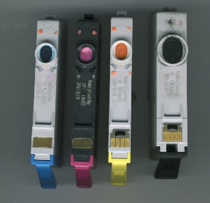

There were no holes in the tubes, HOWEVER when you examine the bottom of the cartridges all other colors were round and looked to fit property (I did not measure the circumference of the holes or ports to verify this as I wasn't interested in wasting any more time debugging someones product) but the black was oblong which lead me to believe it was defective.

I checked the HP Officejet 4620 and it uses the ink cartridges type 564 in US and the similar type 364 in EU. These cartridges are very similar to some Canon single ink cartridges. They use the same contact type interface cartridge/printhead. This interface is not very suitable for CIS systems, normally CIS systems are not recommended for Canon printers with this type of cartridge/printhead interface. Some Epson printers use a spigot type interface which is much more suitable for CIS systems.
I have a couple of HP printers using the EU version of the cartridges, and the ink outlets are round for all cartridges, see this:
So was the supplied black CIS cartridge a wrong type?

Yes, notice the oblong dispenser/contact point of the black cartridge - the other cartridge contact were round, but the black looked like your image.
