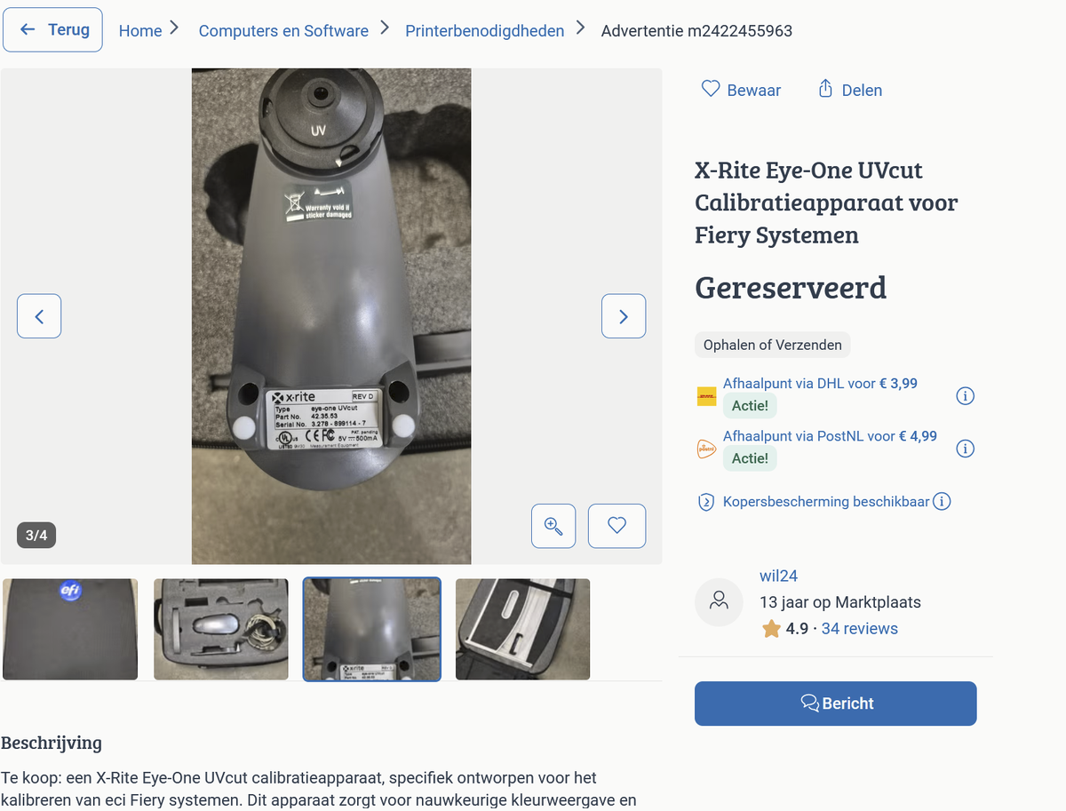

Today I have found a version D uv-cut i1Pro1 (Fiery ES-1000) device. The device is uv-cut, so I think it will give a yellowish hue in bright daylight for OBA containing papers.
So probably I have to use some setting in colprof to counter the uv-cut effect of this device. Because I am using the device for prints that will be pressed between plexiglass plates or behind glass (reducing 98.5% of UV-light), this might not be a big problem. Anyhow the device was a real bargain.
