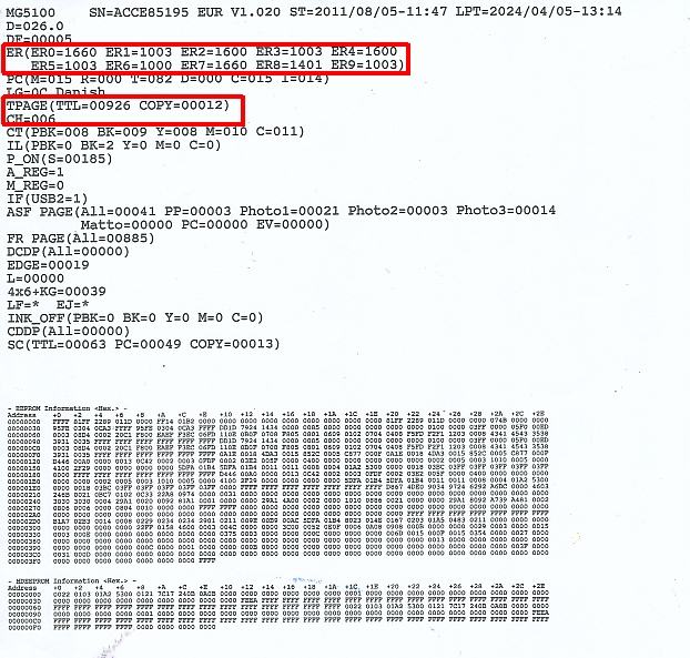

The EEPROM page lists a lot of the printers usage history and problems. If you have still got the EEPROM print from service mode, please upload a scan or photo of it.
As an example here is a scan of the EEPROM print from an MG5150 with some printhead problems, click to enlarge:
Notice the error list, showing the 10 most recent errors numbered ER0 to ER9 with ER0 being the most recent. Errors 1000 and 1003 are no paper in the rear tray and the cassette. Errors 1600 and 1660 are ink may have run out and an ink tank cannot be recognised or is missing. Error 1401 means printhead is not installed. This could mean a problem with the printhead or that it is missing because it has been removed for cleaning.
The TPAGE (TTL=00926 COPY=00012) shows the printer has only done a total of 926 prints and 12 were copies using the copier function of the printer. CH=006 means a printhead was inserted 6 times in the printer, meaning it was removed 5 times for cleaning. If the printhead was never removed after first install then CH=1.
