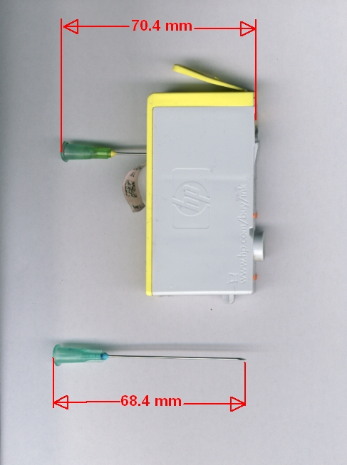

Using two identical needles and a vernier calliper I made some measurements on a HP364 XL cartridge. It seems the material thickness at the bottom of the ink chamber is around 2mm or 5/64", so trimming the bottom to fit the larger chip should be possible without ruining the cartridge. See this:
So ... In reality. It shouldn't make a difference (other than cleanliness) of the new larger chip in place of the smaller one, but to keep the contact patch as close as possible I think I still believe in the custom fit so it's tight and I can "Hopefully " get a good full read from the cartridge instead of an error message saying something is wrong with XY or Z.
