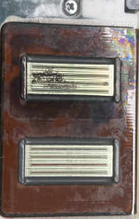

i soaked my print head in ammonia, water and isoprol alcohol...a lot of ink came out but still didnt print black right...I left in longer (STUPIDLY) in a metal tray...I think the metal reacted with the print head - see pic
...is there anything I can do...Its unclear if I could use a soft tooth brush or something on the print head? Any ideas

Your printhead doesn't look good :(
It seems ammonia attacks metals, I stopped using it since long.
Regarding the storage, I pour isopropanol (aka propylene glycol) over (a proven good and thoroughly rinsed) printhead as @The Hat does and store it in a zip bag.
The alcohol evaporates, but I never had problems reinstalling.

Never fill Canon carts with a cleaning solution, that’s a sure way to damage the nozzles, and ammonia can be used for cleaning the head but only for ½ an hour, any longer and the risk of damage increases substantially, and only use paper towels to clean or wipe the nozzles nothing else..
