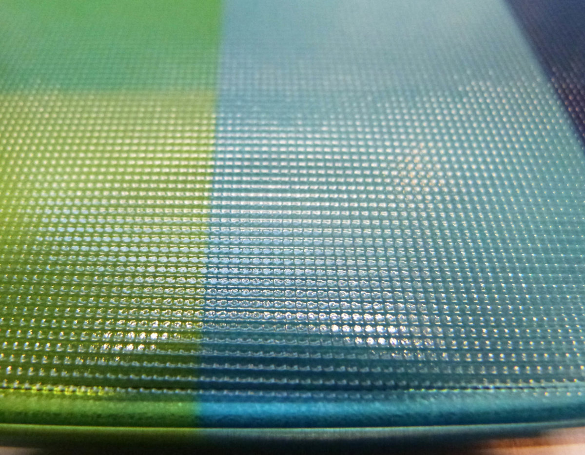

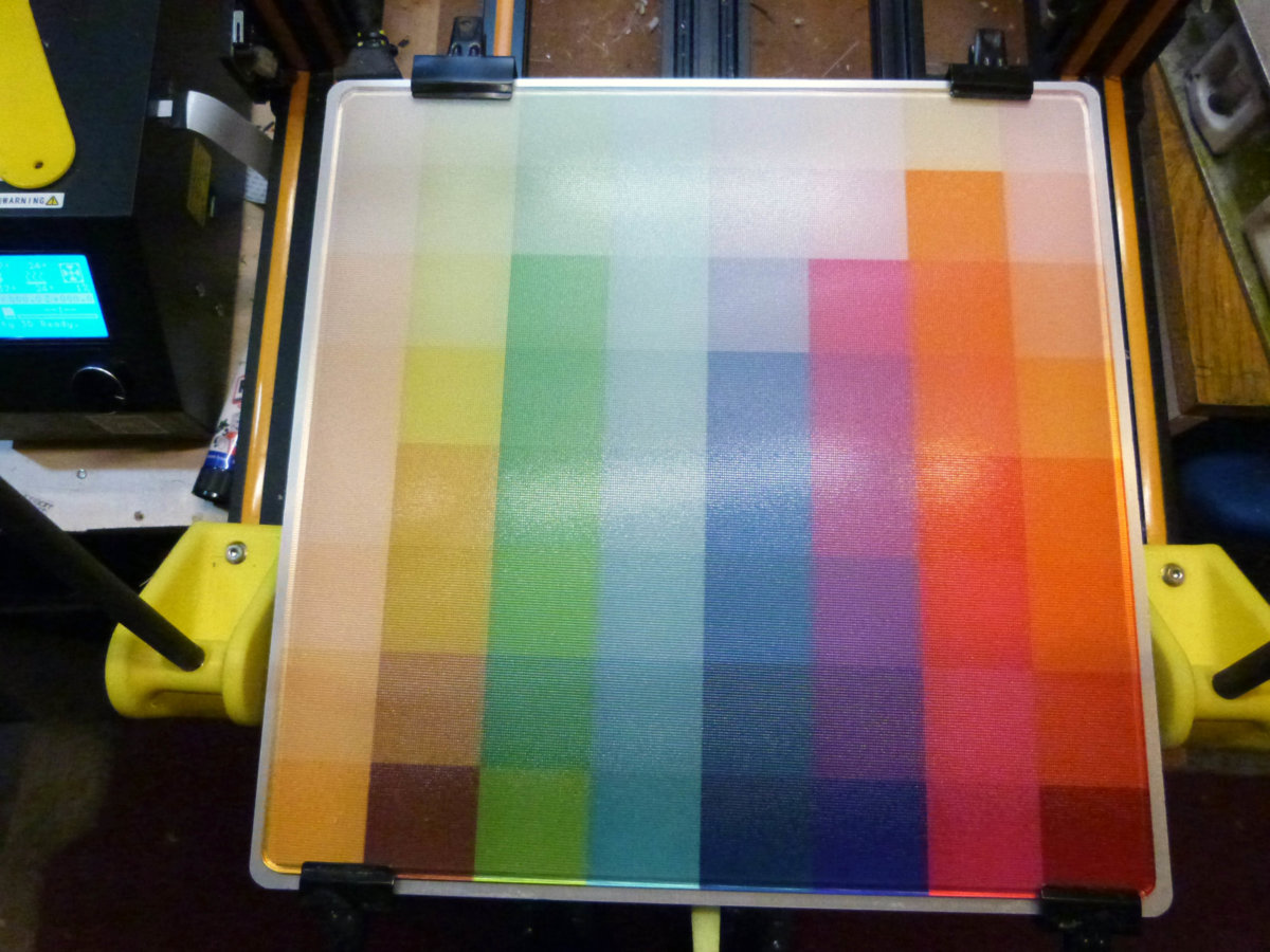

I was able to get a chopping board almost the exact size of the CR-10 platform, its only 5 mm short on the edges but who care, because I won’t be printing out that far anyway...
This glass is toughened and is rated for a temperture of 280c, best of all the surface has nice bevels, good and rough so everything should stick to it, (Should)
The metal bed of the CR-10 has a dip in the middle of it, (Bow) and levelling will be a real challenge, and so has my new glass, (An Auto leveller would be nice) I used 6 varying sizes of foil underneath the glass and stuck them down with hair spray, so they shouldn’t move.
Here are some Pics and the site where I got the board from...
click to enlarge..
https://www.amara.com/products/work...utm_medium=cpc&utm_campaign=criteoUK&amss=e11
P.S. It has just finished my first print job with the new glass, it worked perfect, as it should... Let’s hope it always preforms that way...
