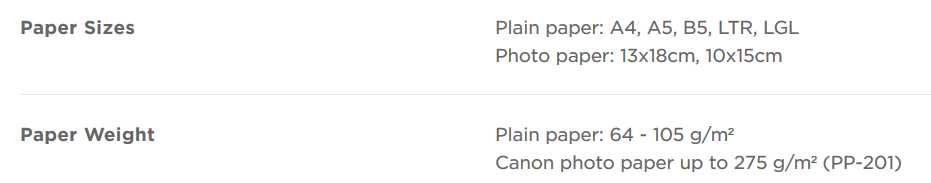

I checked the printer specifications here, and sadly the printer only supports photo printing the formats 13x18cm and 10x15cm. So the limitation is not caused by the OS or a wrong setting, but by the printer specs.

Not trying to tailcoat onto the excellent advice both PeterBJ and The Hat gave, but instead to reinforce it, the specifications and recommendations they gave can be read here, the relevant portions being:
Screenshot_2018-12-23 Canon PIXMA iP2850 -Specifications - Inkjet Photo Printers.png
Without reading the User Manual for your printer, it appears the only way to print an image larger than 13x18 cm is to select "Plain Paper". You may not be able to print "borderless" either, but at least you can print larger than 13x18 cm.
As to The Hat's second point on Paper Weight, note that the maximal weight of the paper is 275 g/m2 regardless of paper setting, though it could be that when using Plain Paper setting that you might have printing issues if the paper weight is greater than 105 g/m2. You won't know until you try it.

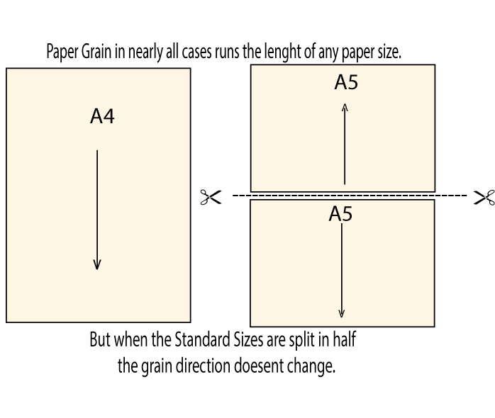

15,916
8,923
What is is about paper grain that alters the dimensions of the printable image, the size of the paper one can use, and/or the paper weight one can use?
When Standard Paper is cut in half the paper grain makes it much easier to fit around the feed system of any Cassette feed printer, because it doesn’t have the same stiffness of its bigger brother, so the smaller paper sizes can be of heaver stock, 105 gm to 275 gm..
7,171
In your example, are you not feeding the A5 into the printer perpendicular to the grain shown in your example? If so, is that what makes feeding of heavier card stock easier?
