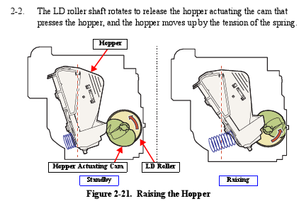

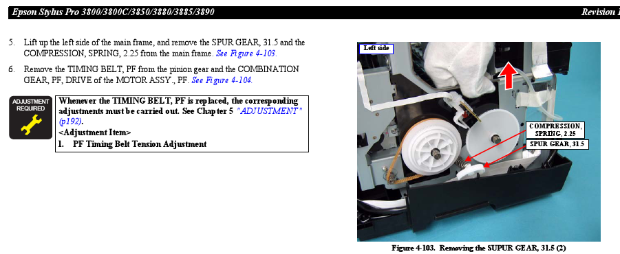

I don't know anything about a P5000, but it looks like the spring on a 3880 used as part of the auto sheet feed mechanism. It might also be the compression spring for the spur gear in the timing belt apparatus. Those are the only compression springs I see in the 3880 service manual.
