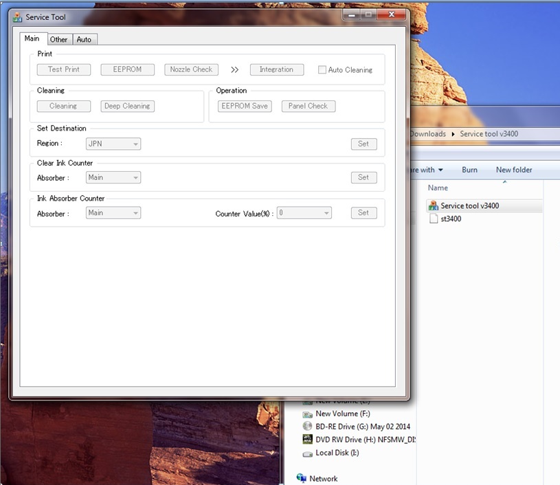

Have moved countries and I am trying to reset my region.
I finally got a copy of the v3400 service tool from 4shared.
When I open the service tool all the buttons are greyed out.
I 'think' I have the printer in service mode but not sure. The method from 2manuals certainly does something but there is no green light the LED is always blue. But the screen is blank and it does a mechanical check (sounds like it anyway).
It also talks about selecting a USB port on lots of these sites but there is not anh option for that on the software.
Any ideas? Thank you in advance!

What is the printer model you are trying to execute service mode operations on? If it can be found, the service manual has the proper procedure for entering service mode and performing service mode operations.
Maybe the procedure from 2manuals for entering service mode is not the proper method for your printer; for most printers the resume button should be pressed two times instead of five for entering service mode. I have also seen mentioning of four and six times pressing the resume button.
But trying to execute service mode operations on a printer that is supported by the service tool, but has not entered service mode, should not result in a greyed out service tool, instead the service tool should produce an error message, error 006. See this post.
The part about USB ports could be the reason the the service tool is greyed out. The service tools only work with an USB connection, and only the printer you want to perform service mode operations on should be connected to the computer; if you have more printers attached to your computer, the other printers should be disconnected.
So for the service tool to work the printer must be able to print in normal user mode, when connected to the to the computer via USB. If it is not, then the simplest way to install a copy of your printer for USB printing is to connect the printer to the computer via USB and turn the printer on and let Windows Update install the printer. This works with Windows versions newer than XP.
When USB printing in normal user mode works, then turn off the printer and try entering the service mode again, using either two or five presses of the resume button when trying to enter service mode. Then open the service tool and try service mode operations again.
BTW the service tools only work with Windows, Linux and MacOS cannot be used, but from your uploaded picture I guess you are using Windows 7 or probably Windows Vista. The version 3400 of the service tool supports all versions of Windows from XP and newer both 32 and 64 bit.

Thank you Peter
The printer is MG4140 (can't believe I forgot to put that!)
Windows 7 Ultimate 64-bit.
I'll look for the manual and post again later :)

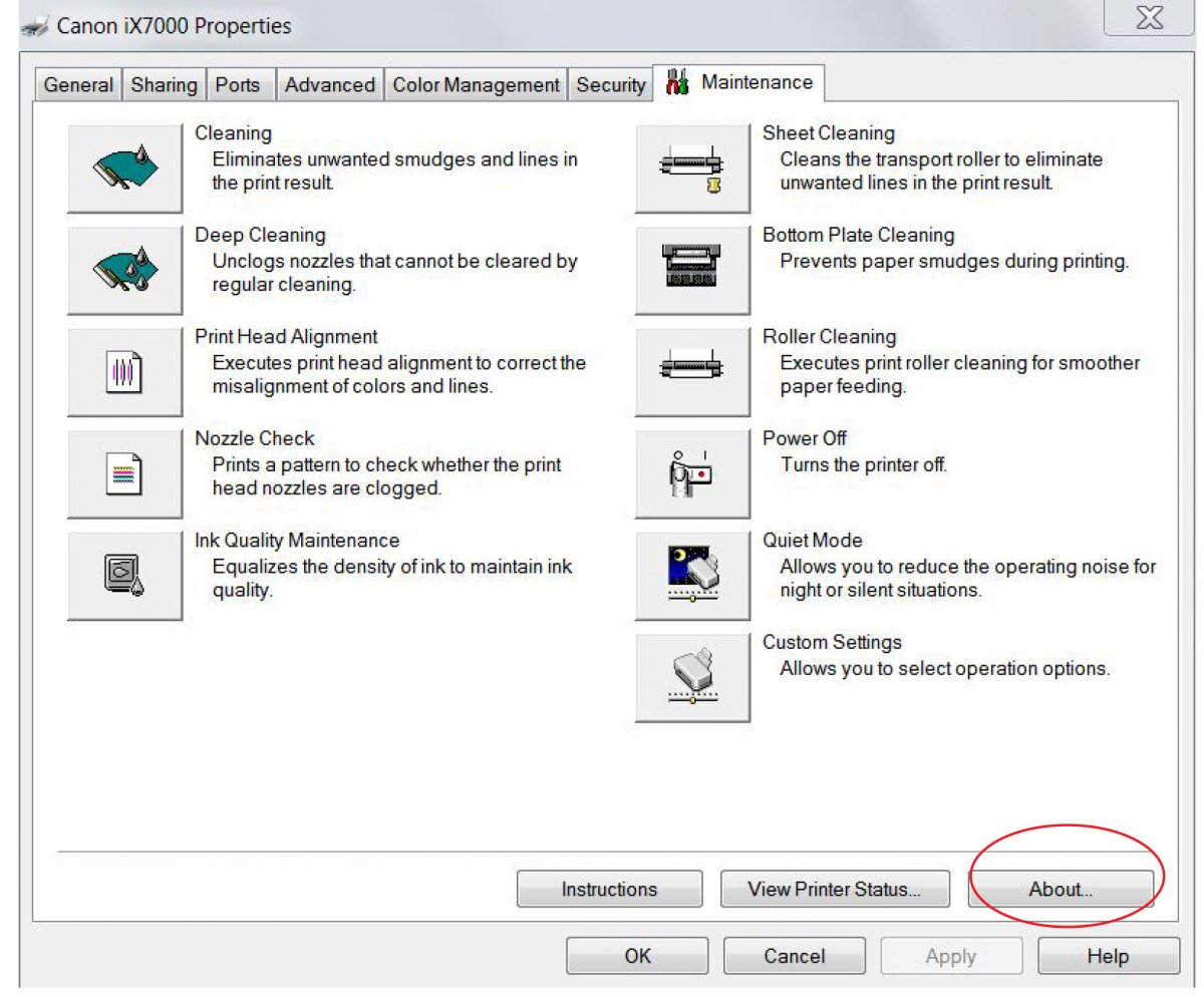

If you do change the region on your printer you’ll find no difference as @PeterBJ has explained all ready, but if you need to change only the language then open the Maintenance tap and click on the “About button”, in here you can select your new regional language..
