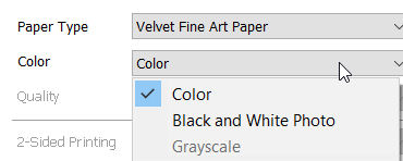

I hve seen some variations how Epson has implemented the ABW mode into the driver, I'm getting this with a ET8550 when selecting the color options for plain paper
I have 2 options - color or Grayscale, this Grayscale option uses the least amount of color inks to my experience but dithers the grays with the black and gray inks.
This mode does not offer many options - I can adjust contrast and brightness, and that's all. This mode does not let me correct a tint of the black ink which may vary by paper type .

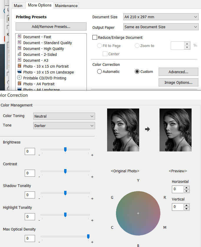

If I select another paper type - Velvet - in this example I can use the 'Black and White Photo' mode
This mode let me adjust the tonality of the B/W print which requires the driver to use more of the color inks
You should see many more color dots under a magnifier when you look to such a print. This mode let you correct a tint as well caused by the paper which the grayscale mode cannot do.
It's the paper selection which gives you the option for one mode only - with the other mode grayed out.
I don't know how much different these driver options are to your 3880 driver.

Yeah my 3880 driver is quite different. Just a checkbox for ABW mode but then there is the screen that you shared last in your post with options for darker and warmer etc plus the ability to dial in a colour shift. I’ve not seen a grayscale option before in any of my epson drivers. Unfortunately the results from my ABW have been awful. It’s as the the tone curve is too steep and the shadows are getting clipped severely Although that’s on my R3000 with marrutt inks so I guess the inks must be quite different. Maybe I’ll try again on the 3880 but first I’ll try and get a profile from QTR. bit tricky as I have an i1studio which is a consumer device. Hard to get the numbers that the qtr needs. It’ll take a bit of research but I think ArgyllCMS will be the way forward.
I'm showing above the driver settings running on Win 10, which OS are you using ?
I Installed the 3880 driver, it offers either a 'Black' mode for some papers - plain paper etc or a 'Advanced B&W Mode' for photo papers etc.
Did you try the 'Black' mode yet ?
6,315
7,529
It appears to me that the driver does not let you use the simple 'Black' mode with any glossy photo paper, only with matte inkjet papers, that would indeed be a limitation. I don't know which paper(s) you are using predominantly.
