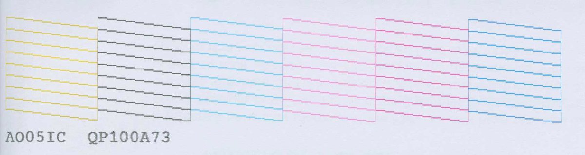

I don't know much about Epson printers but here is a post about a Canon printer with a similar problem. It is caused by a defective printhead, see the pigment black section of the nozzle check.
Uploading a scan or photo of a nozzle check might help Epson experts to diagnose the printer.
Here is the nozzle check.
I am aware that there is some contamination of the yellow channel with black ink so there is probably some head delamination. Printing yellow test images helps clear the channel makes the printer useable.
