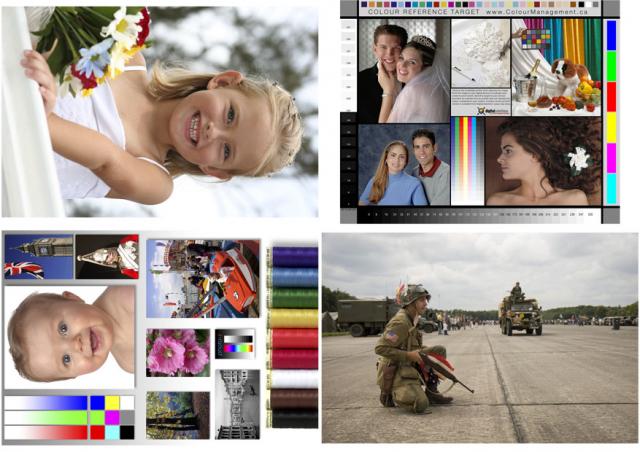

I used the following test image I composed of several pictures and using a cheap type of glossy paper (Label Ocean glossy 230 gsm) and a dedicated profile I produced with the old batch for the Epson Pro 3800 printer.
Now this is the test print I made several months ago with the older batch of IRK4-nano ink. Notice the rather orangy reds of the coloured band on the right.
The second picture shows the same picture printed with the same profile with the latest batch of IRK4-nano ink. Notice the red band is now far more saturated and now is a true saturated vivid red.
Whow finally this problem with this fantastic ink has been solved with their latest batch of IRK4-nano
Note: due to the compression by nifty-stuff.com, the quality is unfornately suboptimal, but the difference in the red in the vertical blue/red/green/yellow/magenta/cyan band on the right is visible. Scans are done on my Canon MX850 scanner.
