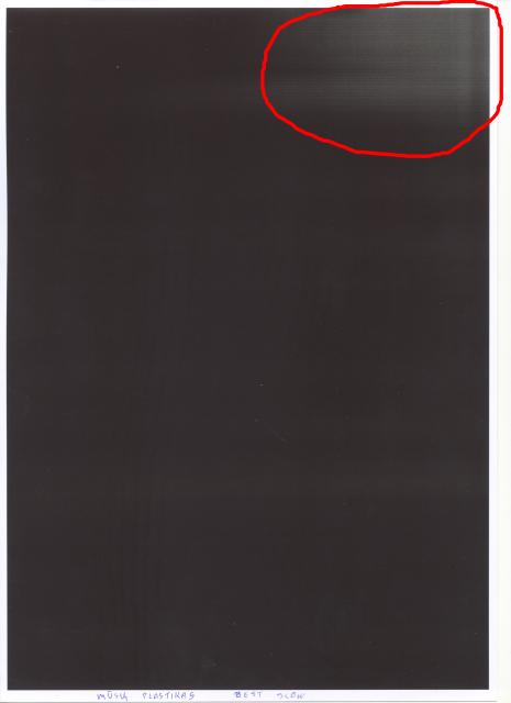

How I found this was that I had a problem with printing from the very beginning of purchasing my P50 with a ciss already installed (from Inksystem) and their own ink. I have a shitty scanner but you will see what I am talking about. Here is a scan of A4 page filled pure black and printed on matte settings, RPM quality:
I don't know how to call this problem, I first thought that too little ink was coming out of the print head and I had to increase it. The problem of not enough ink always appeared on the same place on my paper (top right corner). The problem was not only with black. Other colors seemed to be lighter in that spot too, especially grey color was changing to pink, but dark and black parts were more visible. "Glossy" and "Premium glossy" worked a little better since they pour more ink, but it was a bad idea, since I print on matte paper, so there was "enough" ink on the bad spot, but too much on other parts. So I began my quest on solving this mystery.
First few things that came to mind were:
a) my paper is bad (but ruled out after borrowing another brand matte paper from a friend).
b) my ciss or ink was the problem that caused ink starvation in print head. Checked the tubes, air filters, ciss height level, everything was according to instructions. And nozzle check was perfect every time. None clogged. Checked ink level in carts, there was enough ink in all of them.
c) there was no mechanical damage done to the printer and no parts could have worn out since this printer is only 1 month old.
Long story short I experimented with all kinds of stuff that came to mind. And finally, after a month of searching I found the problem AND a fix! My first post here was posted after 3 weeks of struggling with that damn printer. I stumbled upon a topic on resetters.ru (http://resetters.ru/index.php?showtopic=18855) with some people having the same problem on their T50/T59/R280/R295 and a few other printers.

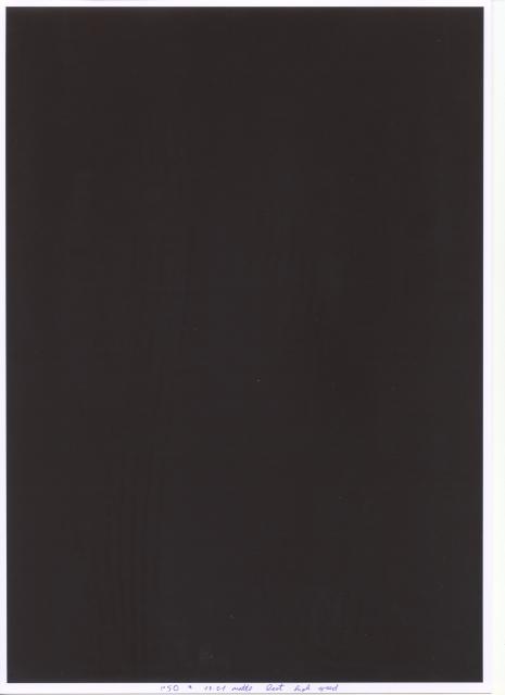

That is a long read so I will jump to the conclusion. Some Epson printers are shipped without a proper calibration. The kind of calibration I am talking about is PF adjustment in Adjustment Program. It is something like a calibration of rows and spaces between them. Spent a few days till I found a working AP program for my P50. There is actually no P50 AP in the wild, but I was lucky enough to get AP for T50 to work for me. Yeah I know they are the same printers, just named differently in different regions, but AP programs have some kind of a restriction that does not let you use them on another region model. PF adjustment prints a test of rows and all you have to do is pick a number from the printed box that looks best and input it in the program. And that's it! As simple as that. After this simple calibration all my prints look beautiful again. And no, this wasn't a coincidence. This problem was always present until the adjustment and after that I've done about 500 prints and it never came back. It helped a lot of other people with the same problem on Resetters forum. Here is a scan of the same black print after calibration:
(It may look worse than it really is because of my scanner that I have since Windows 98 ^^. The print is perfectly black with no visible problems)
I know this may be a very rare problem, but I hope that some day, someone with the same problem will find this information valuable and save himself a lot of time searching for a solution.
