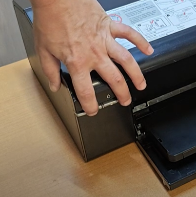

Epson l800 uv
The photo is a crop only for example.
I can't even print the nozzle check from the printer without pc conection, from the printers buttons.
Manulal nozzle check
