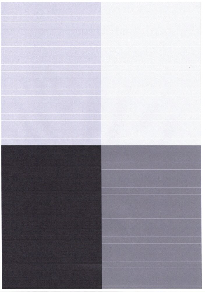

Hi everyone,

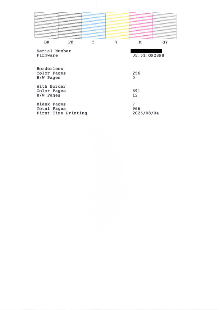

I’m troubleshooting a specific horizontal banding issue on an Epson EcoTank ET-8550 (Firmware: 05.51.OP28P8, Total pages: approx. 966) and would appreciate some technical opinions.
The issue is not general color banding. Pure or saturated colors are mostly clean, but neutral gray tones show very visible horizontal density bands. The problem is most obvious in light and mid gray values, especially around 10%, 25% and 50% neutral gray. Darker gray / black areas are less affected, and 100% black usually looks much cleaner.
What makes it interesting:
If I print color areas without any gray in the image, the colors look mostly fine. But when neutral gray areas or gray ramps are present on the same page, horizontal banding becomes visible, and some adjacent color areas show the same horizontal density pattern as well.
The printer currently uses compatible Epson 114/115 ink, not Epson OEM ink. Therefore I’m wondering whether this could be related to the Gray or Photo Black ink behavior, especially under midtone rastering load.

  • Nozzle check looks complete for BK, PB, C, Y, M and GY

  • Nozzle check still looks clean

Additional test results:

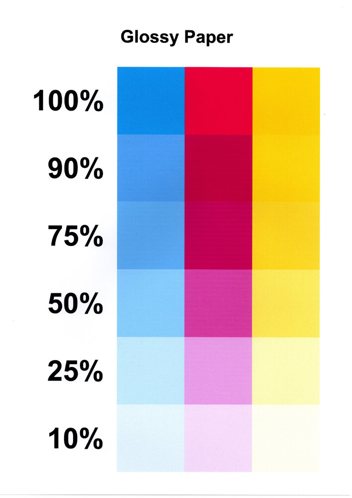

  1. CMY test patches on glossy paper:
    • Cyan, Magenta and Yellow patches are much cleaner than neutral gray.
    • There may be very slight horizontal texture, but nothing as severe as in the gray patches.

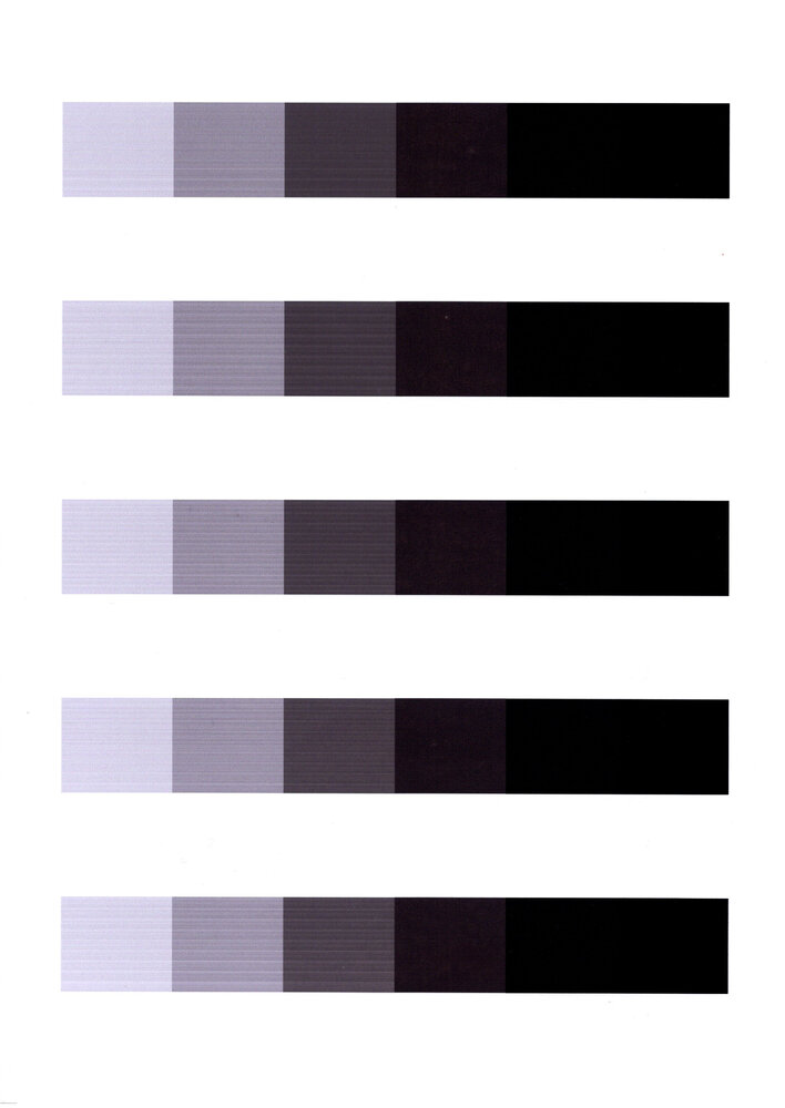

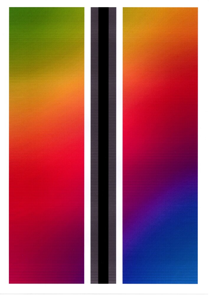

  2. Repeated gray bars:
    • The same horizontal banding appears consistently in light and mid grays.
    • 100% black is much cleaner.

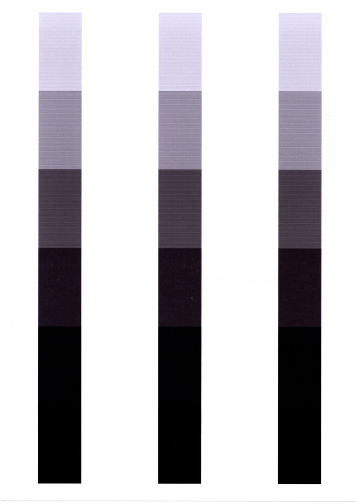

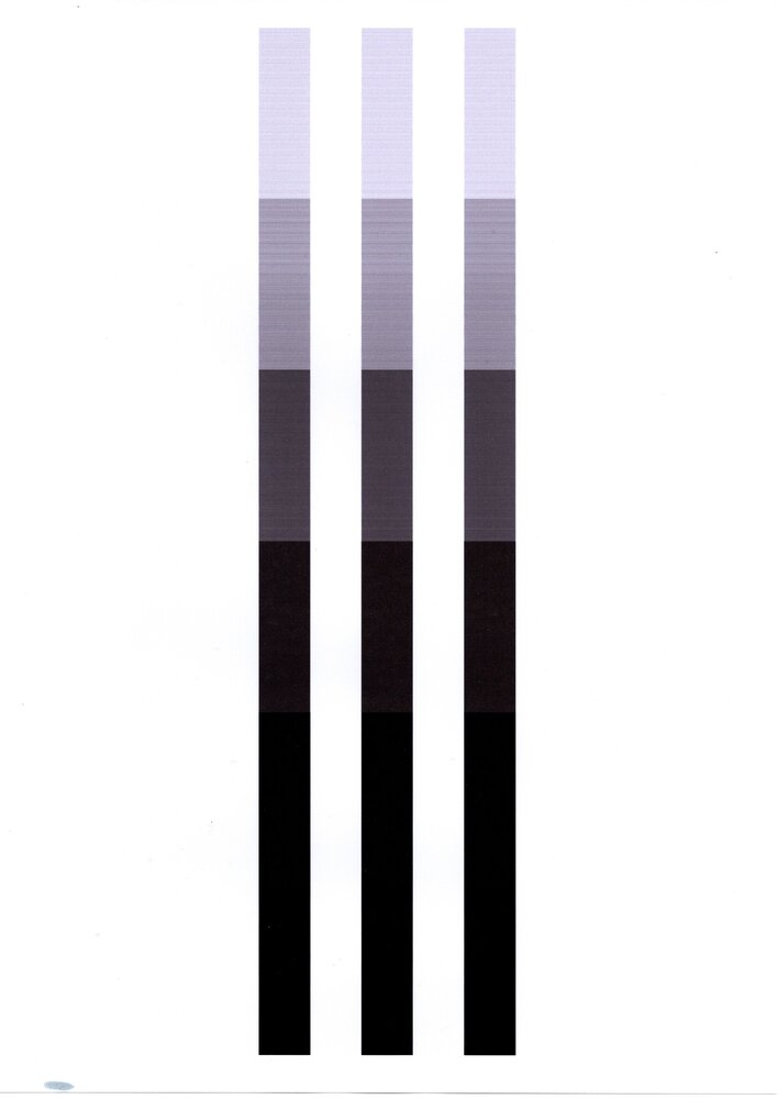

  3. Three identical gray bars printed at left / center / right positions:
    • The banding appears across all positions, not just one area of the page.
    • This seems to rule out a purely local platen or paper path issue.
My current thoughts:
  • It does not look like a classic clogged nozzle, because the nozzle check is clean even after the issue appears.
  • It does not seem to be paper-specific.
  • It may be related to Gray / Photo Black ink behavior, neutral gray rastering, or midtone microbanding.
  • A general paper feed / pass overlap issue might also be present, but CMY patches are much cleaner than neutral gray, so the gray rendering path seems especially suspicious.
Has anyone seen this kind of ET-8550 behavior before?
Could compatible GY/PB ink cause horizontal banding only in neutral gray midtones, even with a perfect nozzle check?
Or does this look more like a printhead firing / paper feed / micro-weave / internal calibration problem?

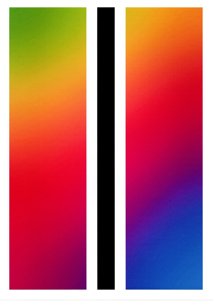

Clean-Test:

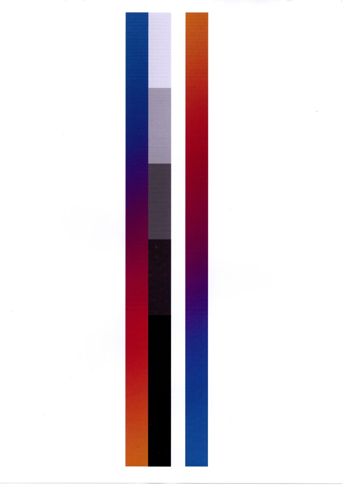

Stripes because of adding gray in the middle:

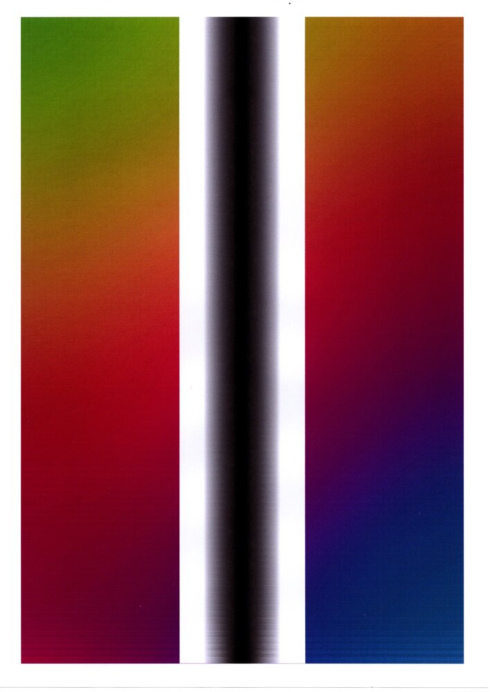

Gradient also affects colors massively:

Quick update:
The issue seems to be resolved now. I printed the same gray banding test again today, and the horizontal bands are no longer visible. The 10%, 25%, and 50% gray areas now print cleanly again.
I did not change anything else in the last 1–2 days. The only previous steps were manually cleaning the PB/GY channels, then running a Power Cleaning and letting the printer sit afterward.
My current guess is that the cleaning process may have left some micro air bubbles, cleaner residue, or diluted ink in the PB/GY ink path. The nozzle check looked fine immediately after cleaning, but the gray midtones still showed banding. After resting for a longer period, the ink flow / nozzle meniscus may have stabilized and the remaining cleaner or air may have cleared.
So in this case, the “wait 12+ hours after cleaning” advice seems to have been relevant — although it took closer to 1–2 days before the gray test looked normal again.
