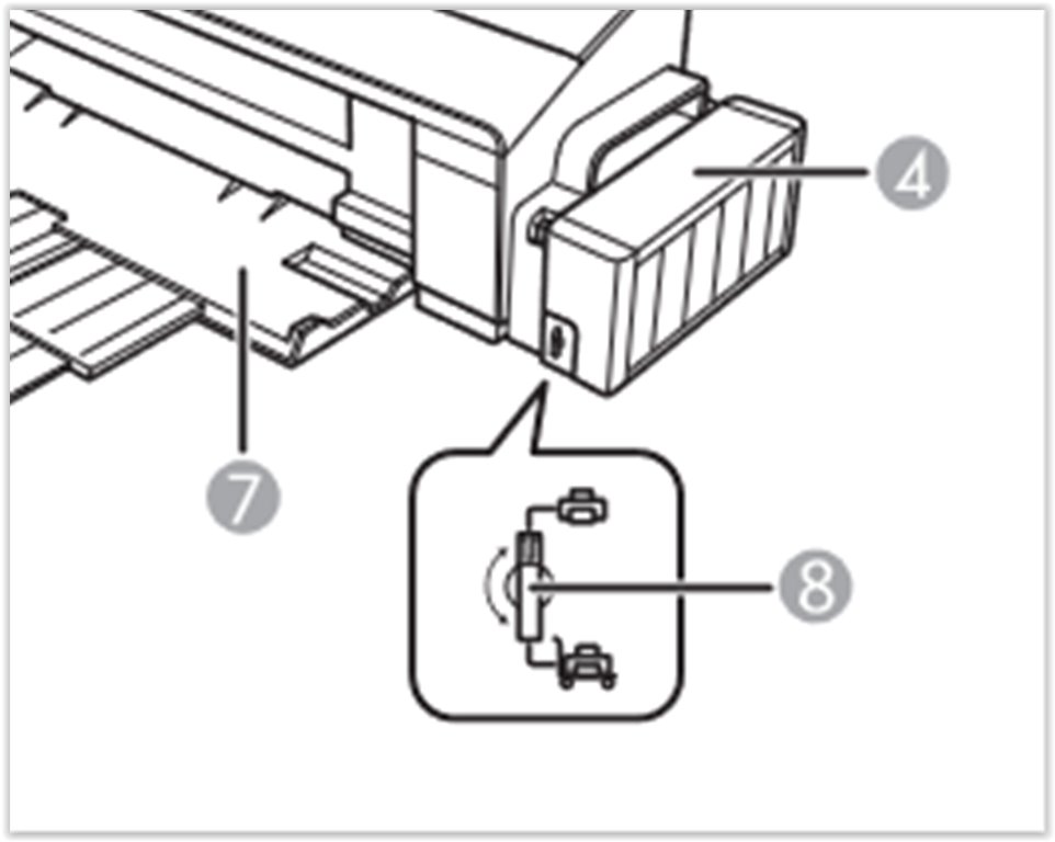

I have just unboxed an Epson L1800 printer for sublimation purposes.
I am using Windows 11. Latest drivers have been installed and I have followed every tip I found on the internet (ink level, page alignment, paper selection, nozzle check etc) to see prints on my paper to no avail. Doing Nozzle Check doesn't even print anything.
I have exhausted all avenues and therefore posting here for assistance.
Note: This is a new printer and never used before.
What am I doing wrong or what should I do? I am sure there are people out there who have had similar problems and have fixed it and I'd like to know how I can fix mine.

Printing blank pages - did you unlock the ink flow as per this drawing in the setup/user manual for item 8 ?
You should run the driver installation from the CD again so that the system does another ink loading.

I have unfortunately installed the driver (from CD) before inks were filled. I later updated the drivers.
I did unlock several times

@signsny - the L1800 is an Ecotank printer without cartridges but with ink tanks at the side.
@Saiks
if the printer is not working at all I would go back to the supplier and get him to handle the issue - replacement or whatever else if he has a service office .
And I first would install the printer with the regular inks to get it working normally , and switching over to sublim inks later.
