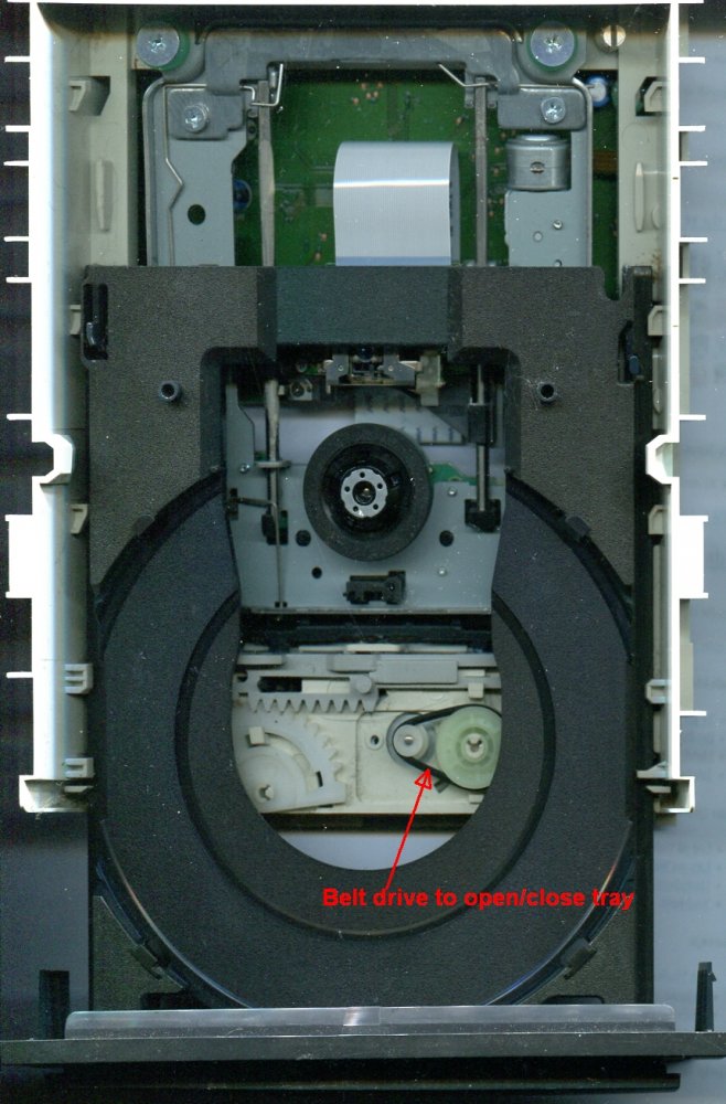

In many optical drives there is a belt drive mechanism to open/close the tray. The belt could be broken, maybe you could find a replacement. Here is a scan of the inner works of a DVD-RW drive:

No Peter the belt was OK and working, incidentally it was two drives, both suffering from being 7 years old and refusing to open, otherwise perfect.

Cleaning and lubricating to reduce "stiction"?
Yes, Peter you are on the right track.
I spent some time trying obvious quick fixes on various parts of the mechanism which did not work. Eventually I realised that it would be necessary to strip the thing right down, to be able to get at all the moving parts. In fact not difficult, remove the 4 short side mounting screws and the four longer screws holding the base plate, which can be lifted off. Release the drawer by inserting a paper clip in the small hole. Depress the plastic retaining tags on each side of the front panel and remove the bezel and the complete drawer, by pressing the plastic spring tag to finally withdraw it. Remove the rest of the case.
Using your image, the grey plastic horizontal gear rack which meshes with the gear quadrant is the principal cause of the problem. It has numerous sliding contact surfaces, with fixed and other moving parts, controlling the vertical movement of the disc platform. This needs thoroughly lubricating on all contact surfaces. I also found the gear surfaces and bearing surfaces from the pulley driven by the rubber belt onwards, needed lubricating. With care you can manipulate this sliding mechanism and determine its relative freedom to travel. Reassembly is the reverse of disassembly, it doesn't take long.

What did you use as a lubricant?
Just for completeness... what drive make and model is yours? I have a lovely Lite-On iHAS524 with a sticky tray.
I think they are all similar in design, mine were labelled Sony. I used an incorrect lubricant, Vaseline petroleum jelly mixed with thin oil, on a paint brush. The correct lubricant is by the look of it, that lightweight white grease, used on printers and cameras, etc., which I don't have.
