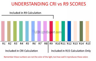

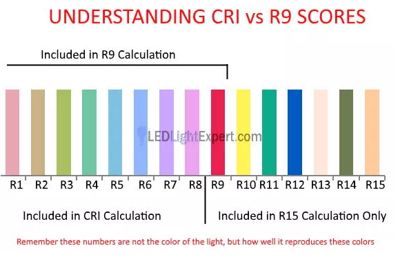

Its worth bearing in mind that a high CRI rating does not necessarily mean a light that is suitable for precise evaluation of prints or indeed any other item that needs to be assessed for colour accuracy.
CRI is a relative value not an absolute. As such it rates sources against an ideal so daylight can be said to have a CRI of 100 but so can a warm tungsten bulb even though they render colour differently.
General CRI is measured in values from R1 to R8 which are pastel colours missing out on important colours such as R9 which is a saturated red, found in food, skin, clothing etc. In other words a critical value for photography, art galleries etc. (see attache CRI graphic)
Up to date LED (other than costly Yuji etc) have not been considered suitable and a D50 halogen lamp from Solux considered the best alternative if money saving a priority over light booths.

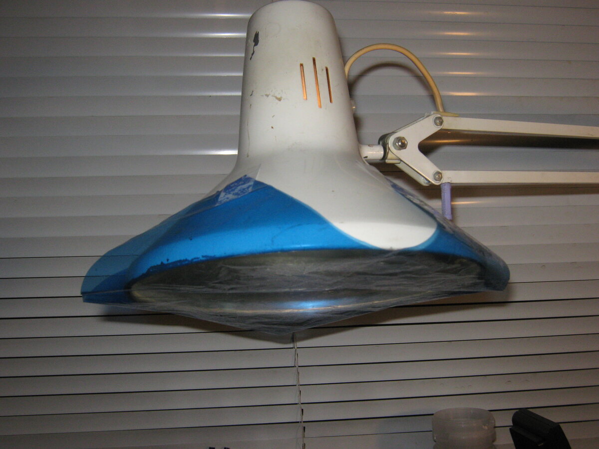

My suggestion to a low budget solution is to use a second hand Luxo lamp with a 60W incandescent bulb and a tungsten light to daylight conversion filter foil. The lamp was salvaged and the filter was part of a pack of 10"x10" samples, less expensive than this.
The incandescent bulb has a continuous spectrum, so I think this bulb + filter might be better than special fluorescent tubes or LED bulbs. I think I will order one of these LED bulbs to give it a try.
But if I adjust the colour balance so the prints look right in 5000K light they look too red in artificial light with the normally used 2700K or 3000K LED bulbs. And vice versa.
The Luxo lamp with tungsten bulb and filter, click to enlarge:

I think it's a great idea to use a daylight filter. In the old days there were two kinds, depending on the color temperature of the bulb. I wonder if heat will be a problem, however, since these bulbs are not designed for use in an enclosed space.
5,250
5,155
I remember that years ago Philips made a 60W incandescent daylight bulb with clear light blue glass. It seems such bulbs are still available, maybe they are NOS. I guess they might also be found for 120V. With a such bulb you will have no problems with the Luxo lamp overheating. It can be seen from my photo that the lamp has been hot and some paint has flaked off. The Luxo lamp is rated for 75W and has a porcelain socket,
