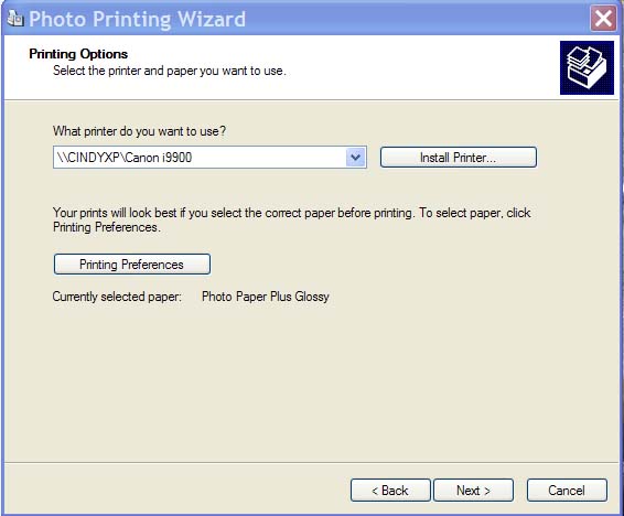

@ Grandad35
In another Forum ( Canon Digital Photography Forums - Canon ICC Profile Guide - Something New for Canon Printers ) you said:
It is possible to use CM with Microsofts Photo Printing Wizard (PPW) (or PS without CM), but it is a little more involved. Select PreferencesMainColor AdjustmentManualSet Enable ICM. Note that the color adjustments on this page WILL affect the color of the finished print when using PPW. It is also necessary to select the desired ICC profile in PropertiesColor Management. Note that on shared printers this information can only be changed on the server, as it will be grayed out on other computers. If Automatic is selected, the ICC profile will be selected based on the paper and quality settings (but why go to all this trouble just to use the default profiles?). If Manual is selected, the profile selected as the default will be used. It is easy to add other profiles and make them the default, but it is a little dangerous in that these settings are global for all users and somewhat hidden.
The thing is I can't find the options in Microsofts Photo Printing Wizard that you speak of. I am using Windows XP.
When I click on a picture the Wizard pops up but there are no options like the ones you home described.
please advise

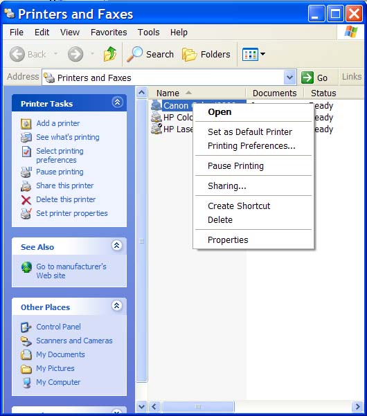

Plevyadophy,
In the PPW "Printing Options" display (the next dialog box after you select the photos to be printed) there should be a "Printing Preferences" button to select the Preferences. (http://www.nifty-stuff.com/img/files/Preferences1.jpg) Preferences set in this way will only be used for this set of photos, and will revert to the default settings the next time that the PPW is activated.
To get to the "Printing Properties" dialogs, use "Start/Control Panel/Printers and Faxes", right click on the printer, then select "Properties". (http://www.nifty-stuff.com/img/files/Properties.jpg) If your printer is connected to another computer and shared across the network, you will have to make these changes on the computer that is connected to the printer. Changes made in this way will become your default settings. If you want to make changes to your default "Printing Preferences" settings, access the preferences by the same "Start/Control Panel " path before invoking the PPW.
Did this answer your question?

Thanks.
Understand what you mean now.
Before, I was thinking that you meant that the Microsoft Photo Printing Wizard had some ICM setting built into itself. Now I realise you are talking about the option that takes you to your own printer's driver settings.
Thanks again, for the clarification.
