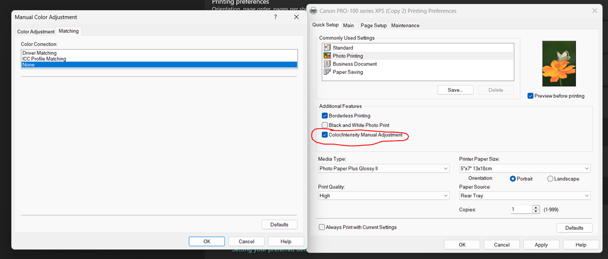

Hello,
I created this Jig for the colormunki photo, since I didn't like the current designs. With this, there should only be a 0.5mm gap between the photo and the bottom of the colormunki (hopefully not affecting readings too much).
However, the profiles I am getting have a yellow cast to them. I used the patches here: Patches
Printing with no color correction gave everything a slight red hue (with some cheap glossy 5x7 paper I had laying around). The initial profile (v1) I got after calibration made everything look Jaundiced/yellowed. I used ACPU and Dry Creek Photo with a Canon PRO-100 with Color/Intensity Manual Adjustment unchecked and glossy media type. (I had to print the patches in borderless since 100% scaling/normal/fit to size modes cut-off one of the patch strips).
The second run is what gave me better results, which was to turn on Color/Intensity Manual Adjustment and under Matching -> Color Correction switch to None. However this v2 profile was still yellowed (but not jaundiced at least). Any suggestion on what I could be doing wrong? Could it just be the paper? Might try with some nicer Red River paper and compare with mine and their ICC profile.
Also in the zip I have added my ti3 file (for v2) if needed.

Hi @oversetay2057
The targets need to be printed with absolutely no color management or color profile conversions, yet with printer paper settings set to the type of paper you are printing your targets. This is not always easy to achieve.
Are you using a Mac or PC, and what software are you using to print the targets? Macs, in particular, have had issues printing with no color management.
One also needs to ensure that the software is configured correctly and that the printer knows whether to use the settings in your software or those on the printer screen.
I would start by explaining how the targets were printed, as a baseline for forum members to understand how they were created.
