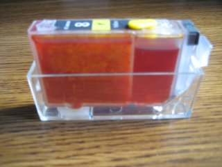

i don't normally plug a company or product but since i returned to refilling from the reservior side of the cartridges (previously using the german method) i found this cartridge clip from another post. not only is it a very good way for storing cartridges, it helps when filling as you no longer need to use your finger to cover the exit port. you place the cartridge in the clip remove which ever plug method you use and inject the ink as the silicone pad in the clip is a tight fit there is no leaking of the ink, the company is compubiz inkjet http://www.inkjetsaver.com/tools.html
they sell the clips for 99 cents as you can see in the photo there is a silicone pad on the left side

the sponge looks completely oversaturated. There is even a layer of ink floating above the sponge. The will certainly gives problems when printing and alot of dripping.......The only good way is to fill the ink compartment half, then close the vent hole above the sponge area with your finger tightly, then fill up to to full and close with the plug immediately. The sponge must be only saturated 50-75% to ensure the natural underpressure.
I think most people (maybe 70-80 %) forget the necessity of an undersaturated sponge to obtain optimal printing results and then they are complaining that refillling gives bad results.....

this cartridge was 1 of the reasons i went back to filling from the reservior side, as you can see the sponge was filling completely, another reason was that the sponge had moved on 2 other cartridges, as there is no perfect method for everyone this is what works well for me, however i have used this cartridge several times without any issues, as far as using the clear clips, you just need to make sure the cartridge is fully forward before locking it into place

I don't know why this clip didn't work for you. In order to make the cartridges fit into the acrylic holder, you need to ensure the front positioning tab(a) sits under the elongated plastic tab(b) of acrylic holder.
click to enlarge image
Mine is only one standard size. The same acrylic holder can be used to hold the CLI-8/PGI-5 cartridges. Not too sure why yours were different that it has 2 sizes where one is a thinner and another is a broader version.
