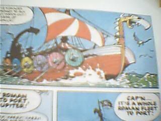

Here's a page I printed before the ink problems:
Here's the same page printed with problems:
And this is the test page I get from the printer's control panel:
Apparently, the clogs seem to be from the M and Y ports.
