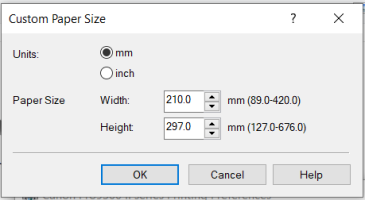

Despite being an A3+ (329 x 483 mm) printer, the driver actually supports a paper size of 431.8 x 558.8 mm, which is almost A2 size. So, if you have a roll of paper that's 431.8 mm wide, you can simply cut off about 560 mm and feed it in through the top feeder.
Comments?

Width is maximum 355mm.
I cut a slice from A2 just in case. From a roll a bit longer, but these printers never had a panorama software update.
PRO-1000 and PRO-300 can do 990mm (as Epsons).

Quote ... the Canon 9500 Mark II has a Custom setting for paper sizes, although it’s a little different from its predecessor, with a maximum size of 420 x 676 mm
Source https://www.photoreview.com.au/reviews/printers/canon-pixma-pro9500-mark-ii/

The main difference between the Pro-1000 and the Canon A3+ models isn’t the maximum paper size but the ink and paper management as well as the overall design of the printer (in electronics and mechanics). The Pro-1000 plays clearly in a superior league and it isn’t intended for amateur use. Meaning that if you print only a few dozens of prints per month it becomes very expensive to run.
As Palombian correctly said, the maximum size admitted by the Pro-9500/10/100 series is 329 mm wide x 676 mm long with the normal tray and 355mm.wide x 584mm long with the manual tray.
No way you can surpass those limits. Even if it’s possible to insert slightly larger and much longer sheets of paper, the driver will refuse to print.
Additionally, the Pro-10, Pro-100 and Pro-9500 impose wide top/bottom margins (30-35mm) when you use fine Art paper settings. The Pro-1000 hasn’t this restriction and. I think, the newer Pro-200/300 neither.
