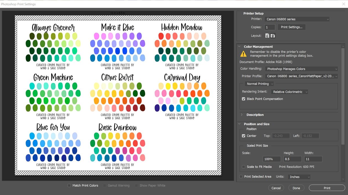

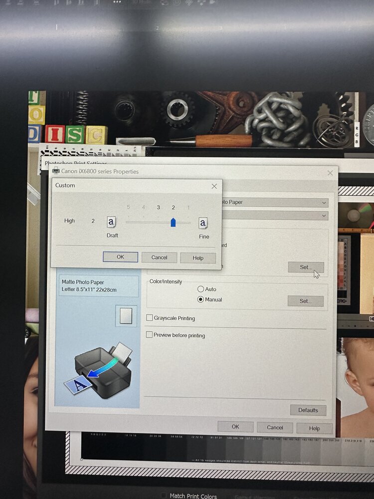

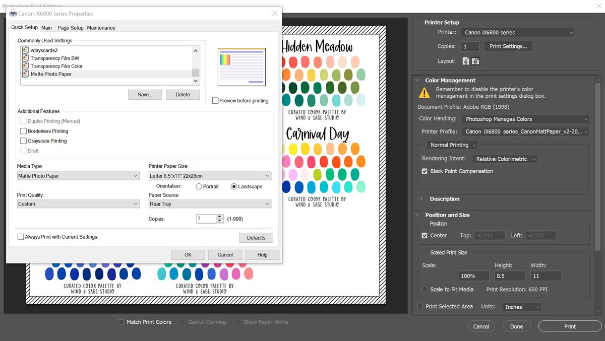

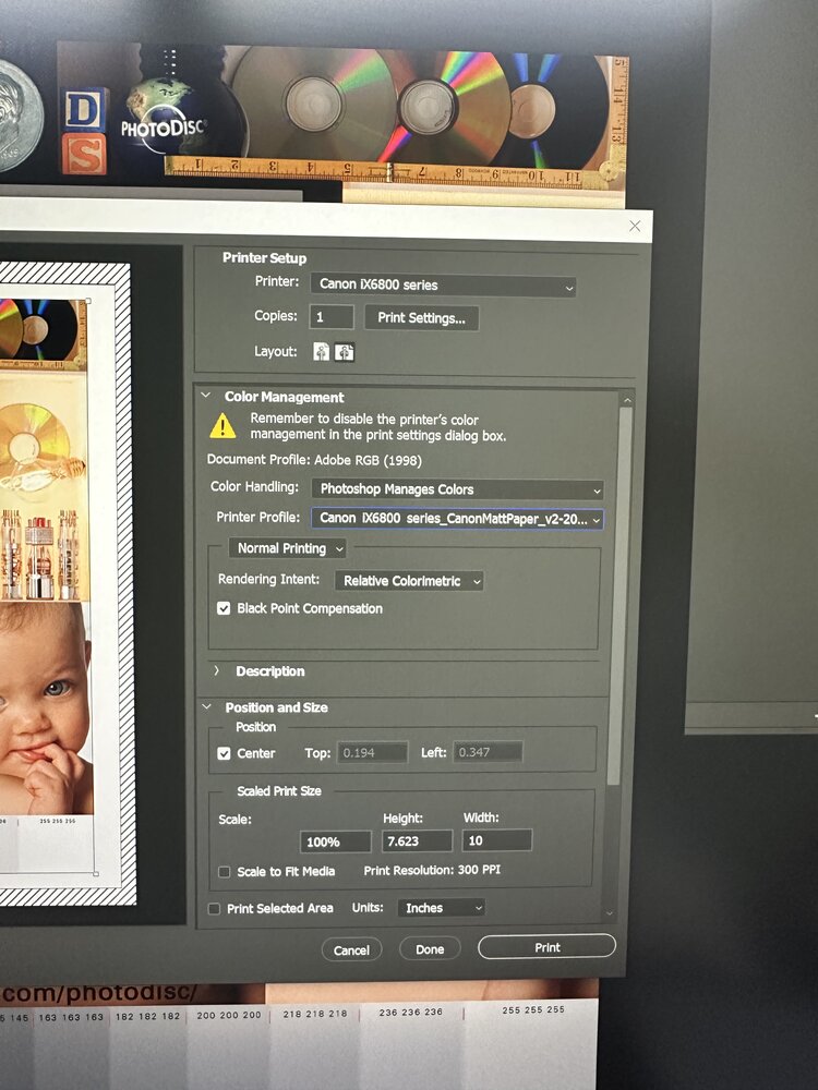

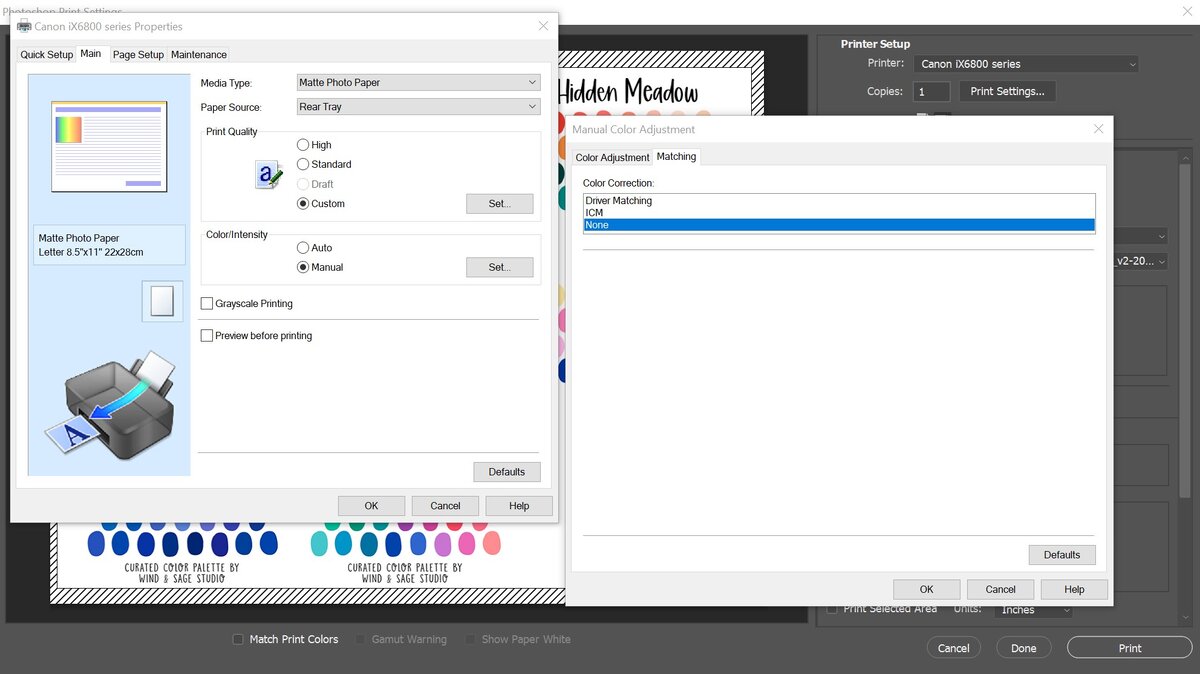

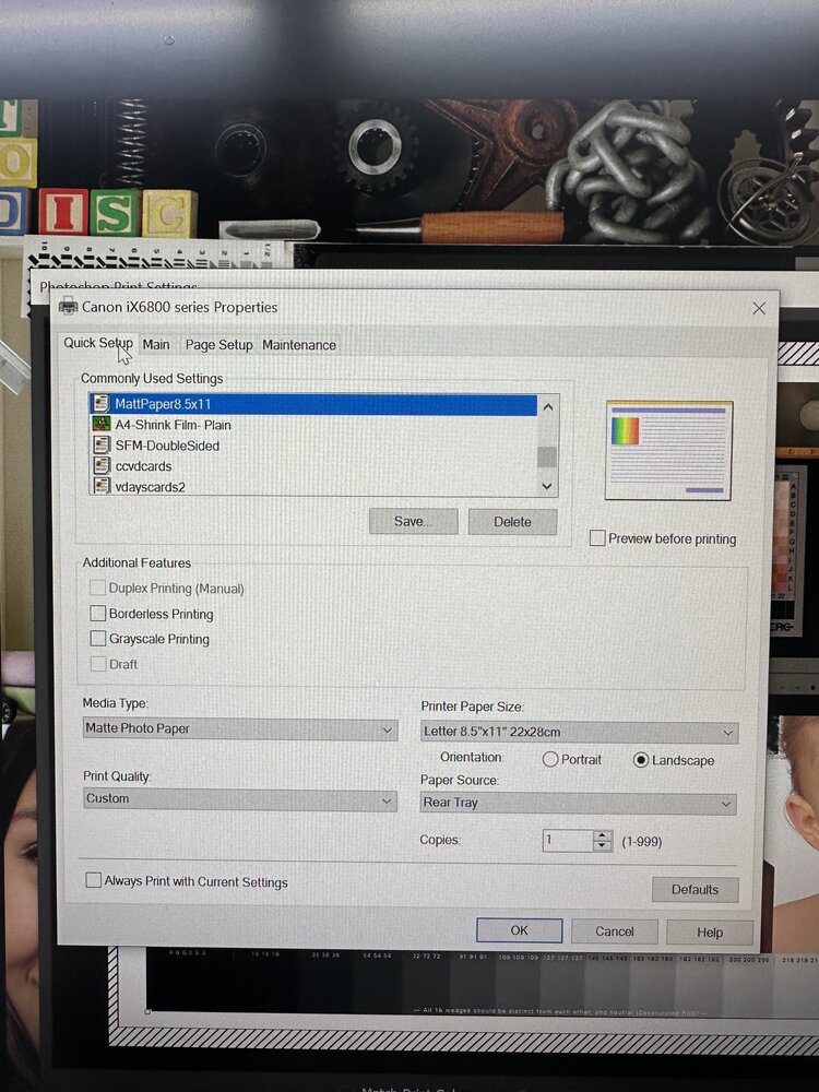

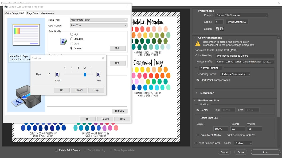

What’s confusing is that I didn’t change my workflow. I double-check all print settings and have them saved per paper type so I don’t accidentally mess something up. I print from Photoshop and make sure the correct settings are selected. When saving profiles, I always create both V2 and V4 versions and label them clearly. When I make profiles with the ColorMunki Photo software, I also add “CM” to the profile name so I know exactly where it came from.

I’ve uploaded recent V2 and V4 ICC profiles I made for my Canon Pixma iX6820 on an uncoated Xerox Bold paper that I need for a current project, in case anyone wants to take a look.

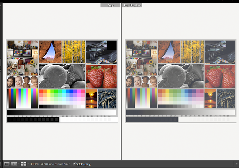

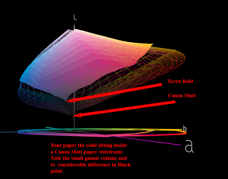

Both profiles appear OK although of course the Xerox paper you use is very limited and likely to produce poor black levels. Note the look of the soft proof version in Lightroom and the limited gamut of the Xerox paper and poor black level in Colorthink
The test image shown in LR is a good example to try and print, better not to use your own images at this stage for evaluation

I’m working on a craft project that requires 32 lb uncoated text paper, and this is my first time printing on uncoated stock. I quickly learned that my Canon isn’t the best with uncoated papers. However, my Epson 3880 handles uncoated paper very well and produces solid black levels when using a custom ICC profile created with the ColorMunki Photo software. After creating any profile, I always print a PDI image target for evaluation—that’s how I know the ccStudio profiles are off. I’m just trying to understand why ccStudio suddenly stopped producing usable profiles on my end. I see that it still works for other people, so I’m not sure why I’m having issues. I save all of my paper settings and use the correct options—if I weren’t, the ColorMunki Photo ICC profiles would be off as well.
