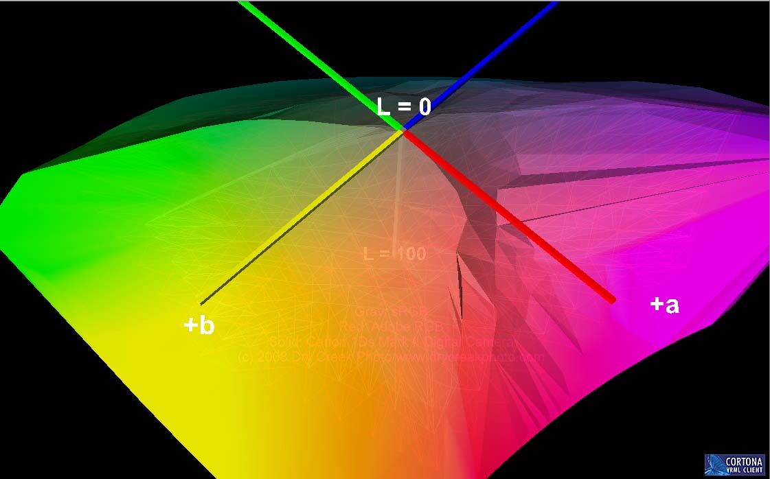

If you want compare the gamuts of color spaces/printers/cameras/etc., I suggest that you look at (http://www.drycreekphoto.com/tools/printer_gamuts/). Color gamuts are 3_D creatures, so you will need to download a VRML viewer to allow you to rotate them into different views to see the differences. Because many people wont want to do this, I have posted 4 comparisons. In every case, the gray wireframe is the sRGB color space, the red wireframe is the aRGB color space and the solid blob is the gamut of the stated device. I tried to rotate them to approximately the same viewing angle. These images were all captured from screenshots.

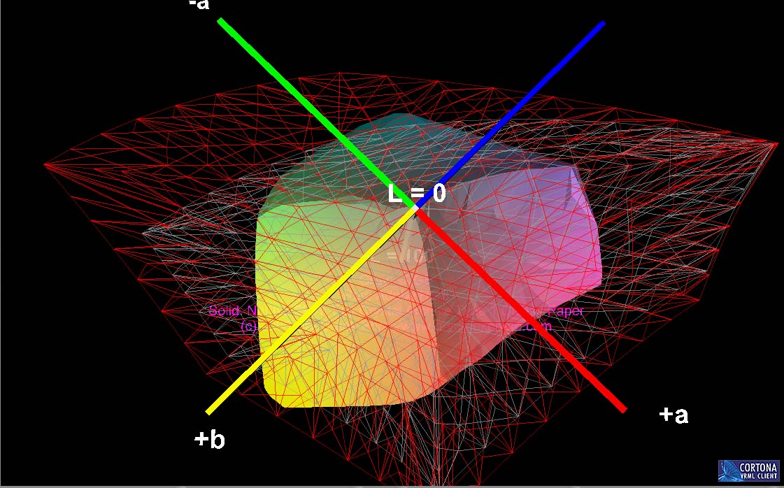

This is the type of photo printer used by Costco (and many others) to print low cost digital photos it uses a traditional Chemical Process to develop an image digitally exposed onto traditional photo paper (Fuji Crystal Archive in this case). You can see that the aRGB color space is larger than the sRGB color space, but that the Noritsus range of colors almost completely falls within the sRGB color space from this view. If you download the viewer and rotate this image, you will find that there are some colors that extend outside of even the aRGB color space.

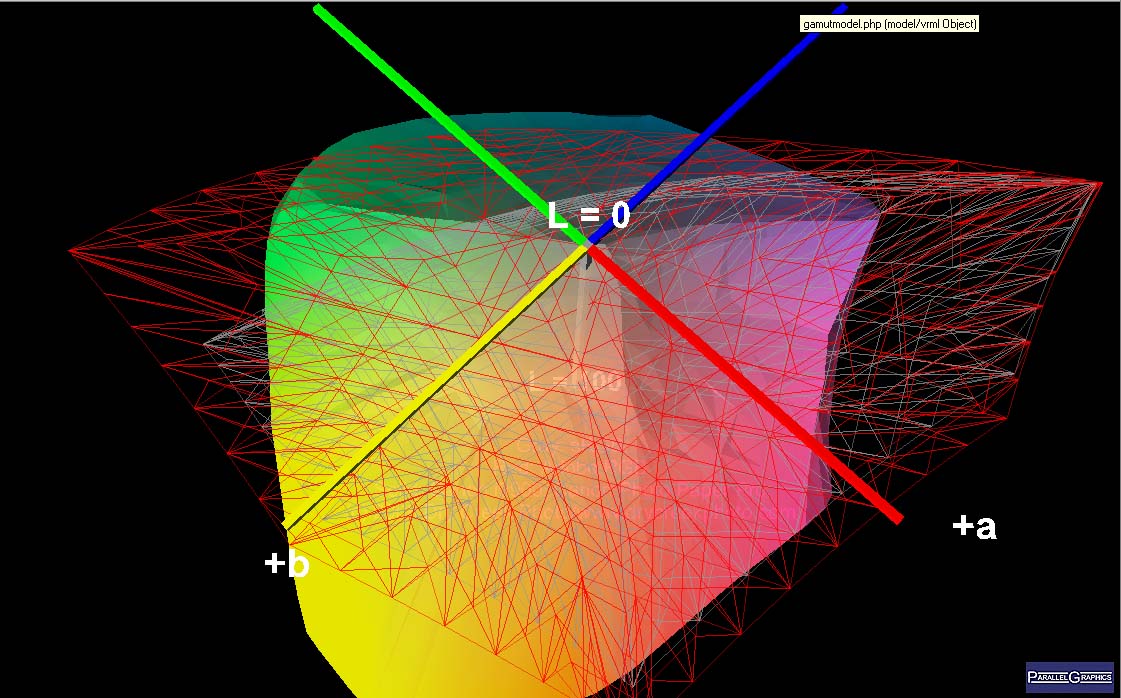

This is the color gamut of a Canon i950 (OEM inks on Canon PPPro paper). This view makes it clear that even an "old" 950 can print many colors that fall outside of sRGB (and some that even fall outside of aRGB). This color gamut exceeds that of a "traditional photo" in almost every area.

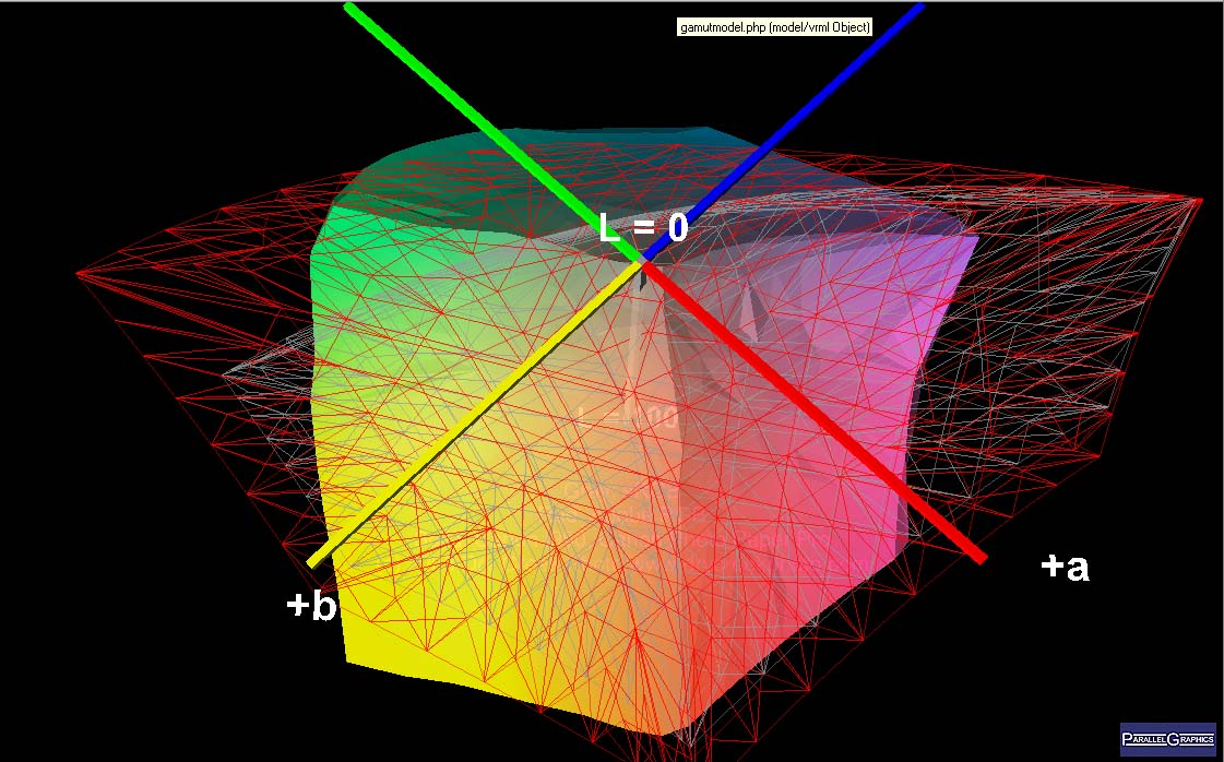

This is the color gamut of a Canon i9900, which adds red and green inks to the i950s 6 inks. As would be expected, the two extra inks extend the gamut in some colors, but not in others.
This shows that digital cameras have the ability to capture colors that fall FAR outside of even aRGB. This camera is a Pro-body Canon IDs Mark II, but even lesser cameras can record values well outside of sRGB. For "snapshot quality" images, our brain does a great job of creating a good color range out of the reduced sRGB color set. However, if you are trying to capture a sunset over the Grand Canyon, sRGB just cant do justice to mother nature.

Grandad, very interesting post from you. Thank you. Could you clarify that being able to print or capture colors outside of sRGB or even outside of aRGB does not mean they can print or capture a color space bigger than sRGB or aRGB? It's hard to get a clear perception from those gamut plots to see how big a color space each one really is.
I am still surprised to hear that some cameras can capture colors oustside of aRGB or even just sRGB. I am a little shocked that some printers can print colors outside of sRGB.
Here is another site (http://back.iccview.de/index_eng.htm) that allows you to compare various gamuts. You still need to download a VRML plugin to view them, but this site allows you to upload your own profile(s). It also gives the volume of a color space, in case you are into numbers.
Tin Ho said:
I am still surprised to hear that some cameras can capture colors outside of aRGB or even just sRGB. I am a little shocked that some printers can print colors outside of sRGB.
Download the viewer and spend some time looking at the various gamuts. Just because a specific color space is larger than another in one area does not mean that it is larger in all areas.
However, unless you are a real expert in this area (and I certainly am not), you should be careful in trying to draw specific conclusions from this data. If your printer has a large color range in a specific color, but your photos dont contain saturated colors in that color region, what good does it do for your prints? A larger color gamut only helps if you actually print those saturated colors. This implicitly includes processing the digital images in a color space large enough to include the colors that you wish to print. If you take an image with the full color range shown for the Canon 1D camera, but save it in the sRGB color space, all of the extra color information will be lost (the details depend on the rendering intent and several other settings).
You have to remember that the sRGB standard (http://www.techterms.com/definition/srgb) was designed to describe the color range of consumer monitors, not as an ideal standard for photos. In fact, if you are in the graphic arts business (your work is printed commercially), you are probably more interested in the SWOP color space (http://www.gracol.org/resources/iccaccept.asp), which has been designed to represent the capabilities of commercial printers (and which has been around since 1975).
As Mikling discussed, a lot of research that went into selecting the inks and drop sizes for the prosumer printers. I tend to trust that Canon and Epson have done their homework and have designed their prosumer printers to meet the needs of a typical high-end amateur.
