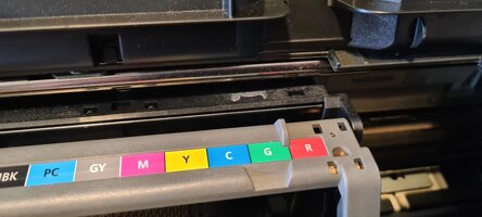

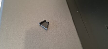

Oh and I found that this piece got broken, it belongs to the upper part of the printhead, please take a look, not sure if it has anything to do with this.

It most likely doesn’t but at least you have the part to glue back in place, but does that mean the print head was not secured turning transit. ?
Examining the paper path carefully might help you locate the paper sensor that’s giving the error, and if you can’t reset it maybe short the wires on the back and disable it..
