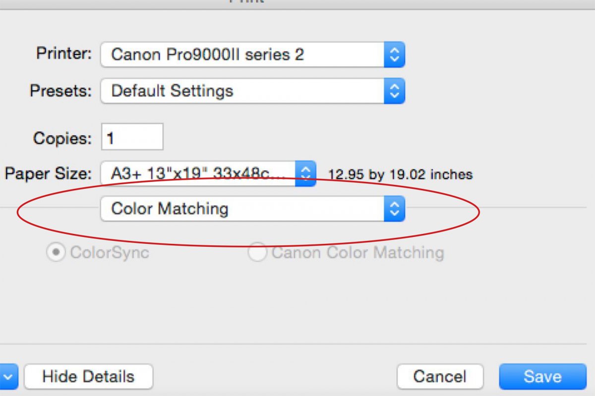

In the Canon print dialog box neither the Color Matching and the Color Options scroll down windows are inactive. I've reinstalled the driver and tried just about everything that I can think of. Probably not getting full use of the printer when unable to use these options.
Can you help to activate these windows? Thank you.

It seems you are on a Mac. Probably you use the color management of your application. Then everything is done by the system. If you choose ”Printer manages Colors” then you should have all possibilities. But if you are using a profile for printing, you shouldn’t change anything in the printer driver.
Which software for printing are you using?

Try changing the colour Matching box and the blanked out piece should become active, like in this windows.
P.S. learning to use Colour management with a Mac is just about the hardest thing in the world, firstly you need to master the Mac printing system, it’s so complex to anything that windows uses..

Thank you so much for your reply. This issue has come up now, as my trusty Canon i9900 is not printing row II colors on the test print. The Pro 9000 is good for certain colors, not good at all for others. I was advised that I can get the sought after results by working with the printer preferences on the Pro 9000. Since I don't know what that is, I thought this might be a way to adjust the colors slightly. I have tried choosing "Printer Manages Colors" and that doesn't change availability. I have been switching up the profiles in an attempt to match the results produced by the i9900. Using Photoshop CS6, on Mac OS X Yosemite 10.10.5, keeping it that way to maintain availability of Photoshop. The driver, downloaded yesterday, is Pro9000 Mark II Series CUPS Printer Driver Ver 16.20,0.0 10/19/17. Do you have suggestions on how to get closer to the colors achieved on the i9900? Or other suggestions? With my utmost appreciation
View attachment 12253View attachment 12252 Click to enlarge..
Thank you for your reply! Scrolling up or down on the Color Matching box brings up the other options within that window, it doesn't change availability of Colorsync or Canon Color Matching.

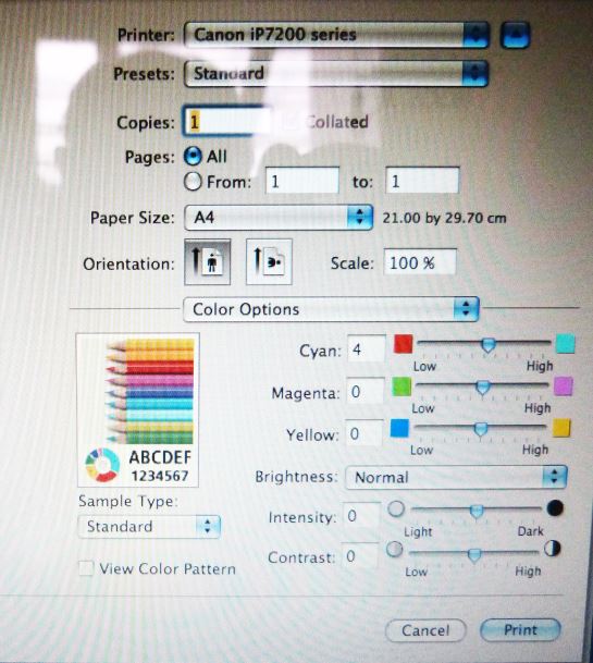

I went back and cranked up my old laptop and took a photo of the settings. As you can see when you choose Colour Options the colour intensity box opens and in there you can change all your colour setting.
By rearranging these setting you can alter and manipulate any colour print to give it the desired affects you want..
View attachment 12258 click to enlarge
That’s what I thought you were referring to. Alas, as you‘ve seen from my other posts the scroll down for color options along with the color sliders are not active. I don’t know how to turn them on! Tried profile settings, Printer Manages Color, pretty much every permutation, except the correct one! Suggestions ?
