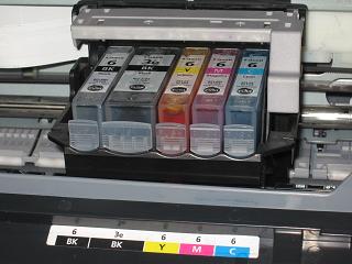

I'm not sure what you mean. Let me ask the question another way. As you look at your cartridges when you open the printer cover, what are the letters and numbers on each cartridge from left to right. They should be;
6 3e 6 6 6
BK BK Y M C
Here's a photograph which isn't very clear if you look at the cartridges but the label below the print head is very clear:
Is that what you have or do you have something different?

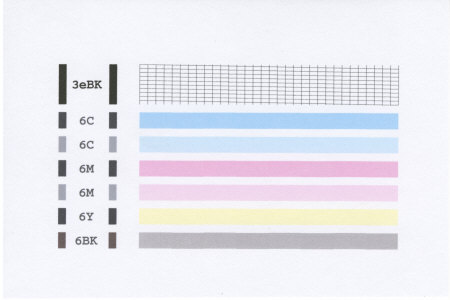

Can you also do a nozzle check?It should look like this:
Do you know how to do a nozzle check?
http://www.nifty-stuff.com/img/files/Print_Head.JPG

Thanks again and the pic of the cartridges is exactly like mine (sorry about that. LOL) The label is clear. I have done 'deep clean' etc., and also a nozzle check. The light blue does not come out as a solid line, but light blue (solid line) and under that a lighter blue and the rest of the lines are as they should be
I sure appreciate your time troubleshooting for me. I am still trying everything I can think of.
I'm not sure what you are trying to communicate here. Are you saying that your top cyan (light blue) bar is not a solid, consistent color like it is in the picture? Can you take a picture of it and upload it?
