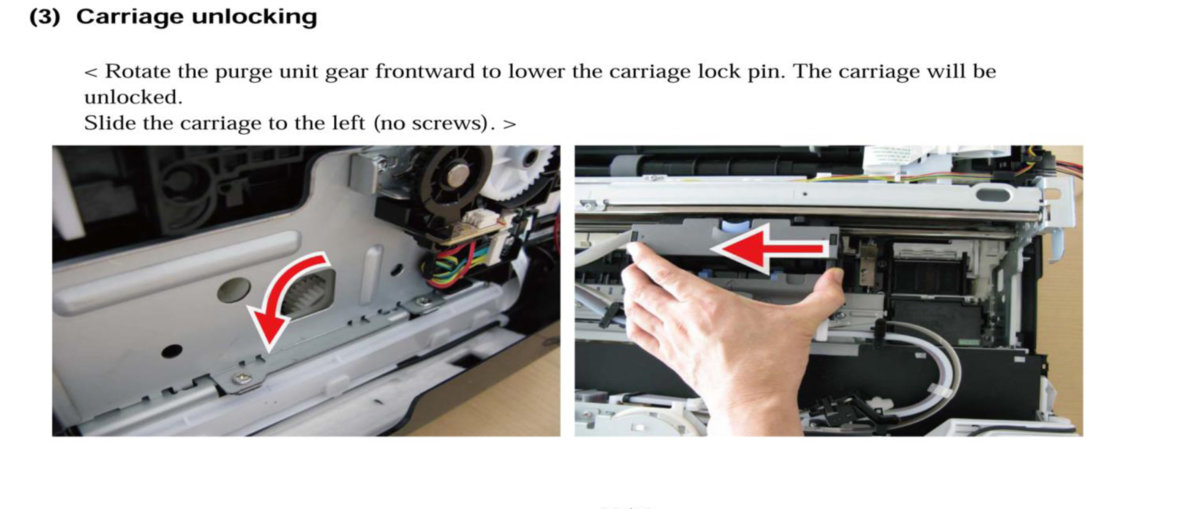

Hi guys, I have had the dreaded B200 error message on the printer. I was experiencing banding issues with the grey and black heads and no amount of cleaning sorted it. Also I attempted to carry out a head alignment check via the utility and since then the head absolutely will not move.
I have since ordered and received a new printhead, however I cant install it as the printhead will not move.
I have had the printer unplugged for a few days but as soon as I power it up I get the 10 sequence flashing light problem. Any ideas how I can overcome this???
Any sequence of buttons I can press to override? Or will I have to attempt to take the printer apart??? Any help would be brill.....
16,163
9,115
Any trouble removing the cover, just PM me...

I had the print head stuck out of sight, but likely for a different reason. If I remember it was "my" mishandling of a cleaning cycle; never found out exactly why.
To get the print head out I had to disconnect the power; not ever recommended, but in this case I had to because the "power button" wouldn't do a proper shut down properly. What I had found on the Internet was that with the power off the print head can be moved freely along the slide.
So, with the power off, and the cover open, I made up a long strip of 3 or 4 layers (for strength) of masking tape. This I stuck into the out of reach area and with a small stick pressed the sticky part onto the flat part of the print head. That allowed me to pull the print head out into the open. Hope this help somewhat.

If you leave your printer unplugged from the wall for a day or two, then that should have some effect, next reinsert the plug and power on the printer, and when the printer starts up, watch the print head carefully, and once it moves slightly pull the power plug very, very quickly. This will allow the print head to move freely by hand..
Failing that:- here’s instructions by @ FWP for the top cover removal..
