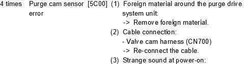

4 flash error code unexpectedly starts to flash. Checking the SM gives the following:

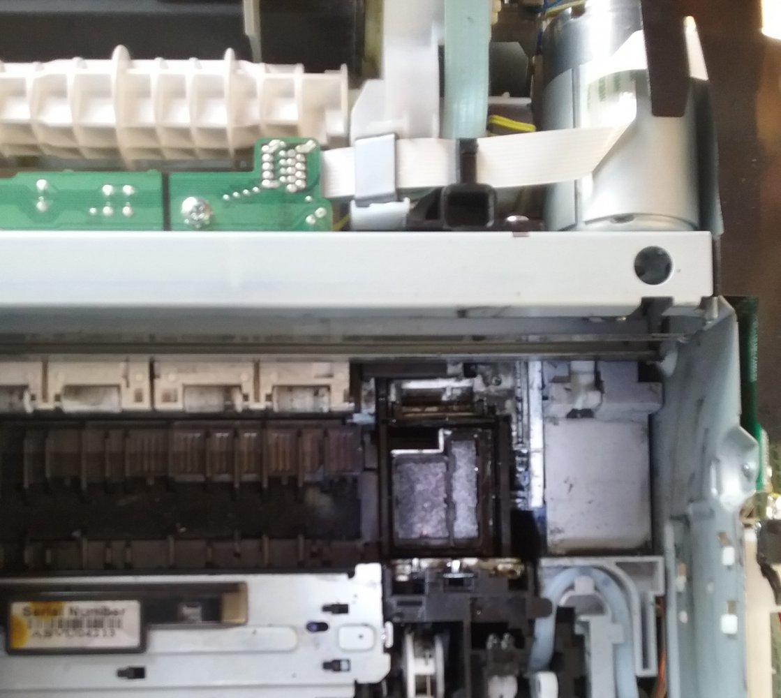

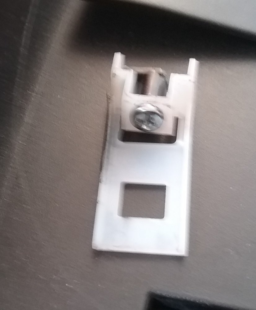

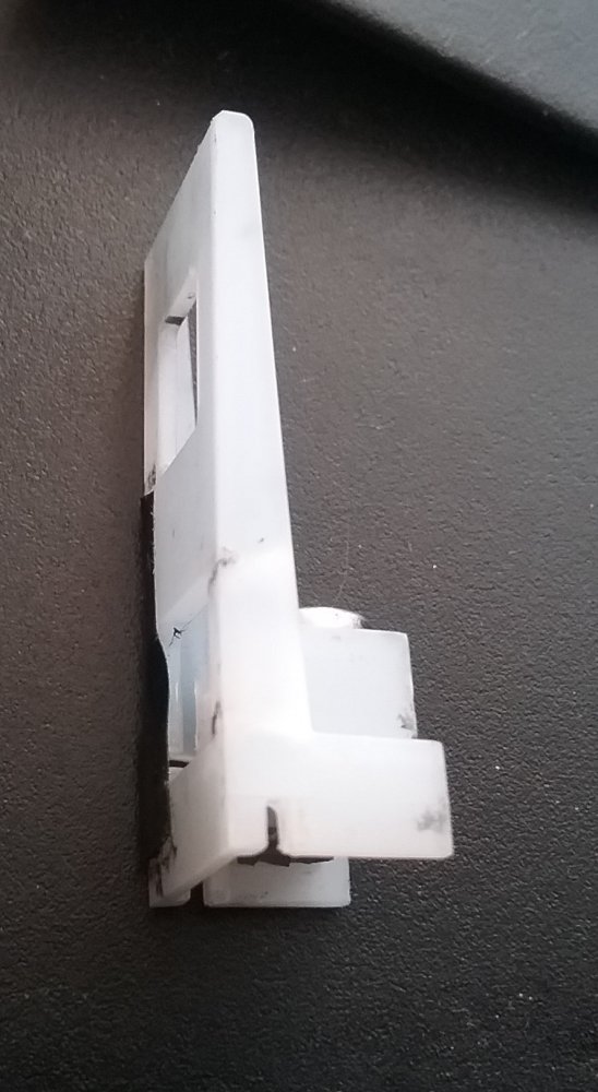

I could hear something loose inside the printer so I disassembled up to point where I could see inside the top and the sides. (pic)
A paperclip fell out as did a small plastic part (T1-5) with break in the side-arm which I patched up with black tape (pic). I don't know where it should go!
I've cleaned the purge unit top as far as I can with methanol and cotton buds etc.

I still need to investigate valve cam cable connection from SM but don't know where that is or how to proceed with any further dismantling.
