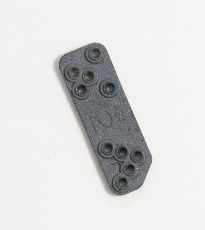

Perhaps there’s another possible thing to check. The rubber gasket inside the printhead, between the white ceramic plate and the channels of the different inks coming from the inlet ports above. This gasket has the purpose of preventing leaks and mixture of the inks. If there was a crack in the rubber on the part between the holes for the magenta and yellow channels, both inks would mix.
I assume that this is a very rare instance but, everything else discarded, considering that the printer wasn't used for a longtime, that rubber gasket might have self degraded with the years.
See below. This is from one of my ‘deceased’ printheads. I don’t remember which one.

Another cause of cross contamination is breakdown of epoxy bonds inside the print head, due to age and heat. The iP3000 might be close to 20 years old.
7,176
Taking apart the print head is a last ditch effort as you are likely to fatally damage the print head.

  16. No leaks or rubber gasket defects. It would be extremely difficult to not strip the screws while removing the ceramic base.
See below. This is from one of my ‘deceased’ printheads. I don’t remember which one.View attachment 11235
Removing the ceramic base is close to impossible without stripping the tiny screws. The screws on the old MX850 print head are stripped from this.
In American Football this is the Hail Mary pass.
You're right, every time I did that, I knew beforehand that it was ‘desperate surgery’ to try only when nothing else works. A last but tiny chance of fixing the problem. One or two times I didn't damage the printhead on the process, but couldn't fix the previous problem either. Three or four other times some tiny tracks in the flexible cicuitry broke and that was the end of those printheads. They died gloriously with their inks on. :D
Anyway, if that rubber gasket is damaged somewhere, unless you have a spare, it won’t do any good to remove the screws to open up the ceramic plate.
If no external leaking is seen as I wrote above then the leaking/mixing begins inside the print head.
Your print head is broken. You can try surgery to find the issue but the chance of a fix is remote.
You need a new print head. Then there is the issue of an old printer, possibly poorly stored, and experiencing a myriad of problems. Why spend money on a print head that may be a Chinese refurb dressed up in counterfeit packaging with high failure rates?
The best thing to do, economically and headache-wise, is get a new printer.
